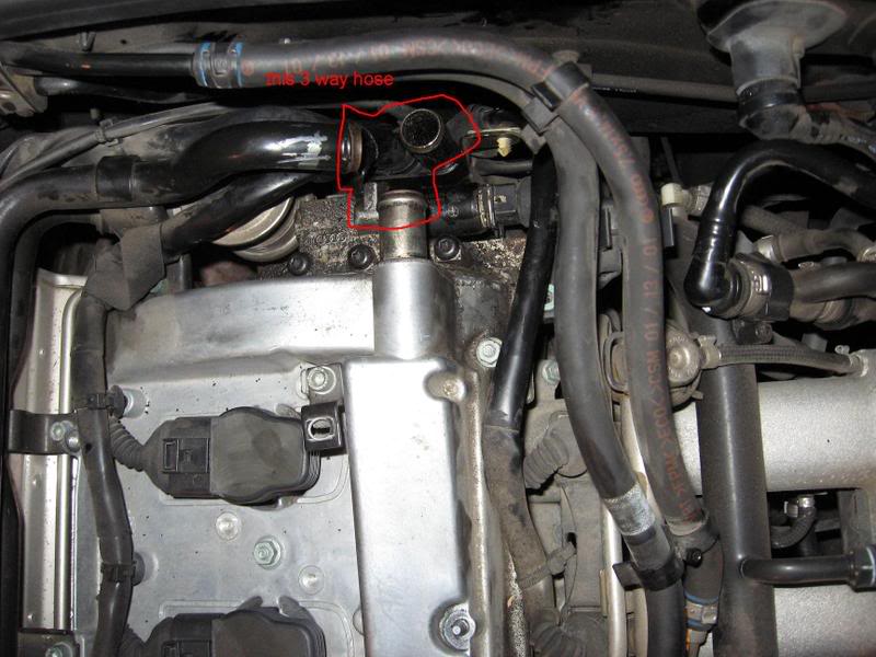

Need the part number for Audi or VW. Only have a VW dealer here.
Was trying to replace my CTS and found this hose was ripped. Ripped it to shreds trying to get it out of the way. Also, if someone could point out where the CTS actually is I ran out of daylight and haven't found it!
This is an 01 Audi A4 1.8t Quattro.

If you go to a vw dealer they can look up that part on a Passat w/ AWM engine code. The engine coolant temp sensor should be right bellow and more towards the passanger side of the 3 way hose.

pretty sure the CTS is what I circled in red.

I took that off but it looked like only a 2 pin connector. I could be wrong though.
