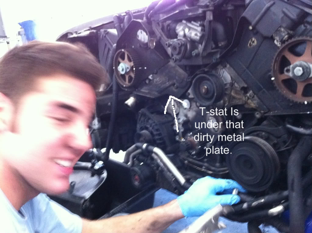

By far the easiest way is to remove the front of the car. Yes it's more work, but it's far better than trying to wedge your arms down in there, fumbling for bolts you can't see, trying to fit tools down there without damaging the radiator. Pull the front end - easy to do and it'll make life a lot easier.
X2.. I really wish I would have taken pictures when I did my TB. I could've made a DIY.
JHMotorsports 2.7t timing belt video is almost 95% the same for the 2.8. That's what I used for reference during my TB job.
Like ImTheDevil said, remove the front end, drain the coolant, swing the radiator out and enjoy the room to work!
My friend mike replacing my lower coolant line for me. Good guy. Name:  TBJob-1.jpg

Looking at that picture, I like the way he marked the position of the cam gears the way he did. I believe I have just absorbed his method and made it mine. Thanks for posting that.

Definitely mark the cam sprockets but do it asymmetrically so that you can only align the marks one way. Example, mark it at 3, 9, and 12 o'clock. Mark the belt also, so you know that you don't jump a tooth if it slips while changing the thermostat. If you have a buddy to help, keep the belt tensioner but slide it forward halfway off the passenger sprocket and have him hold it there (on a threat of death if he lets go for any reason). You'll have just enough room to pull/tap the channeling plate over the bridge of the thermostat and move it out of the way.

That's what I was thInking, I usually do a couple near 12 o'clock but I was saying I liked how he had it marked at each quadrant.

The way I did it was I marked it, took zip ties and put them around the cam gears tight enough to keep the belt on
