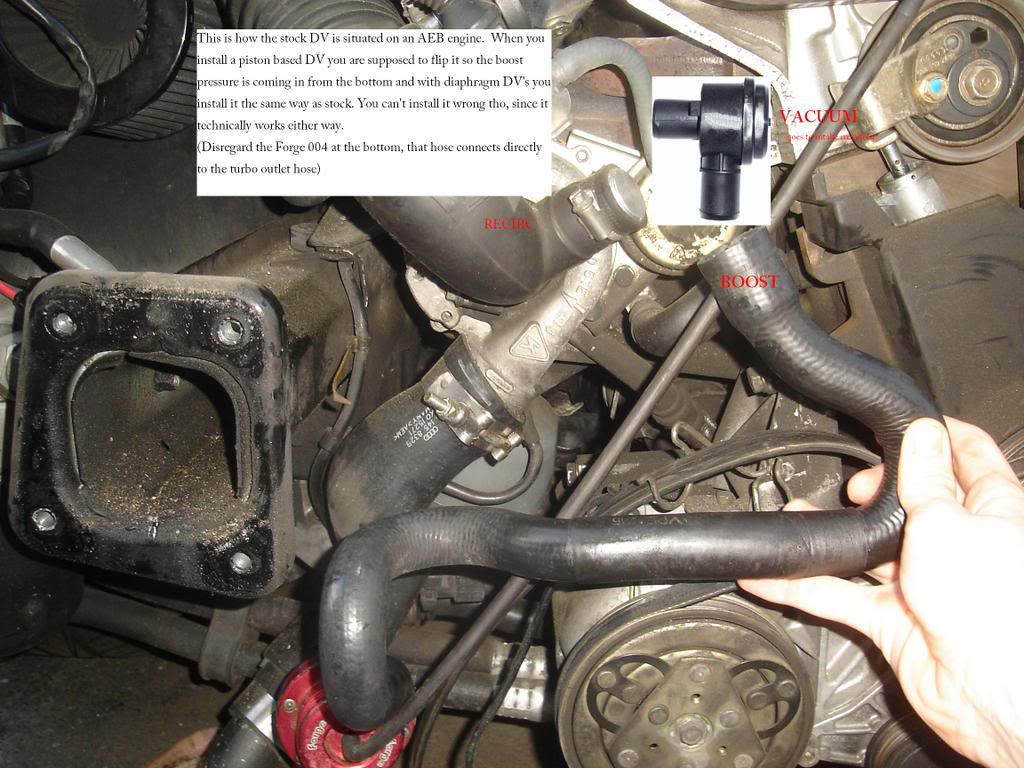

Question Anyone know were i can find this hose in silicone???
I need the hose that chao92287 is holding up in this picture. it goes from the dv valve to the turbo inlet. I have googled it and still no luck, my is split and i would like to replace it with a silicone hose.

I dont think anyone makes one seeing that the exact hose in the picture was only used on the 97. The one for the 98-2001 was different because Audi moved the bpv to the bottom.

were the red bov is is were my dv is on my car so the hose should be the same

Hose in the picture is for the A4 1.8t that came with the BPV up top mounted into the turbo inlet hose.
Here is what the hose looks like for the A4's that came with the BPV mounted down below in the turbo outlet hose.
Samco made one for the early year AEB like the stock one you posted a picture for. Problem is that it was only included in a full kit and turned out to be too small of an ID so it wouldn't fit over the BPV.
[/QUOTE]
yea im finding that out any other ideas on what hose to use to replace it??

Just get the OEM one, silicone wont make a difference at all.

You could try using a standard hose or the flex hose that Samco sells.
