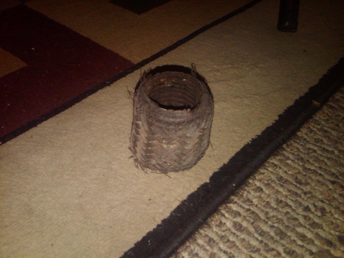

I have a 2001 A4. I am looking for a part for my exhaust, but I don't know what it's called. I tried searching online and I can't find it. I am attaching a picture. . can someone please tell me what this is?

That is mesh that covers your flex joint.

Thats a piece of your flex pipe. Since you have a V6 there's two, i suggest you replace them both. a universal one will work.
