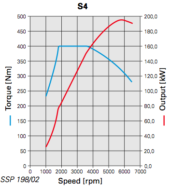

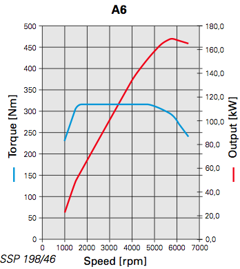

The 2.7t in the A6 was detuned, compared to the S4. It has a more of a comfort oriented setup that has different torque and power output.
Stock S4 Power Output

Stock A6 Power Output
