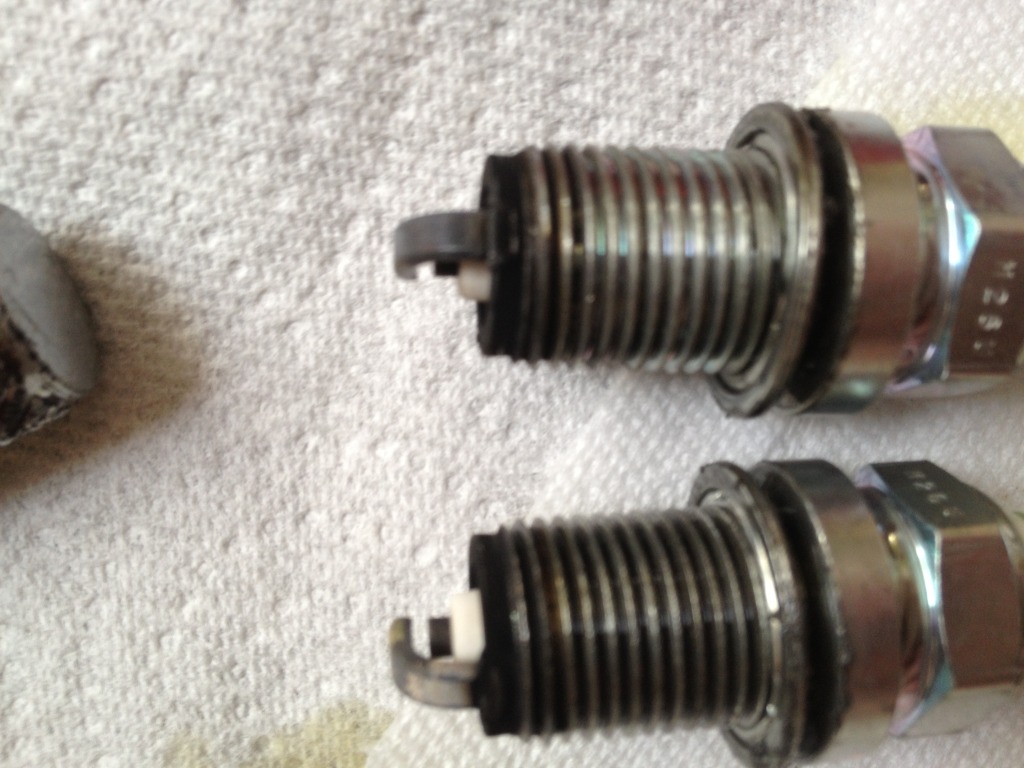

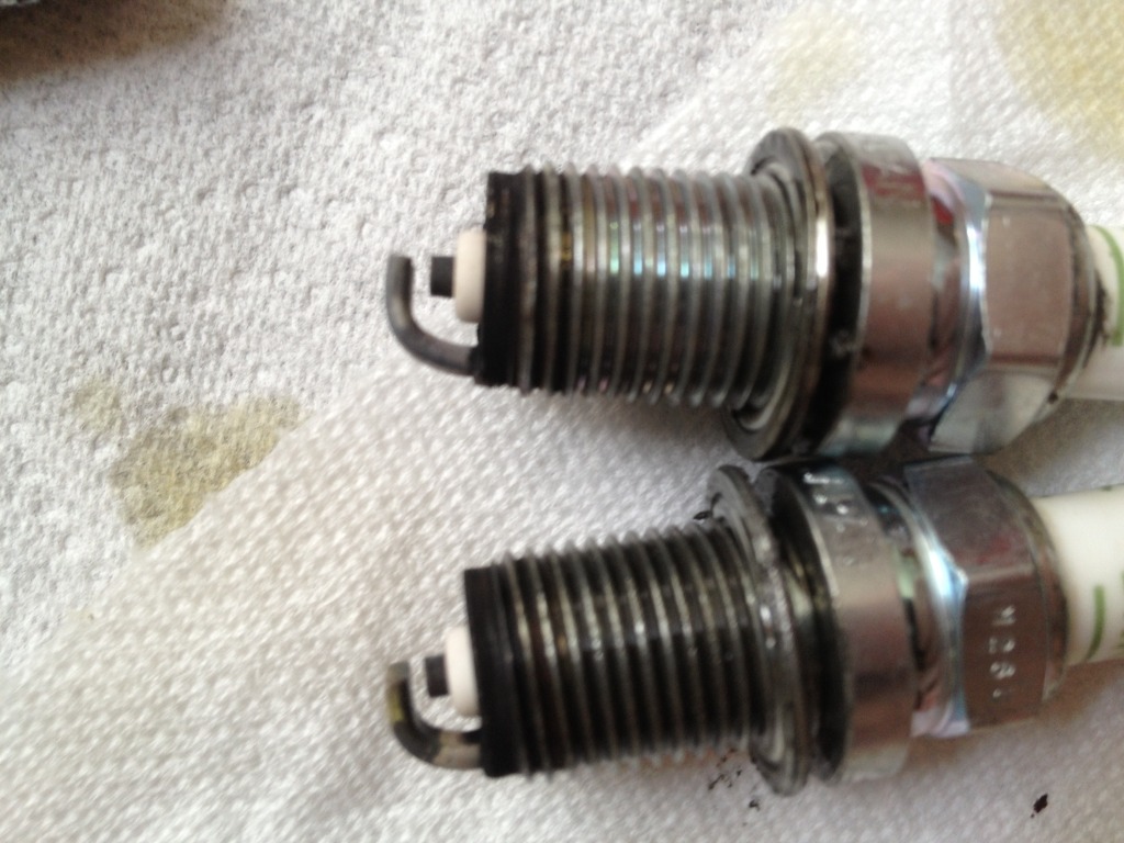

First 2 are from cylinders 1 and 3 ( the ones that were "misfiring")

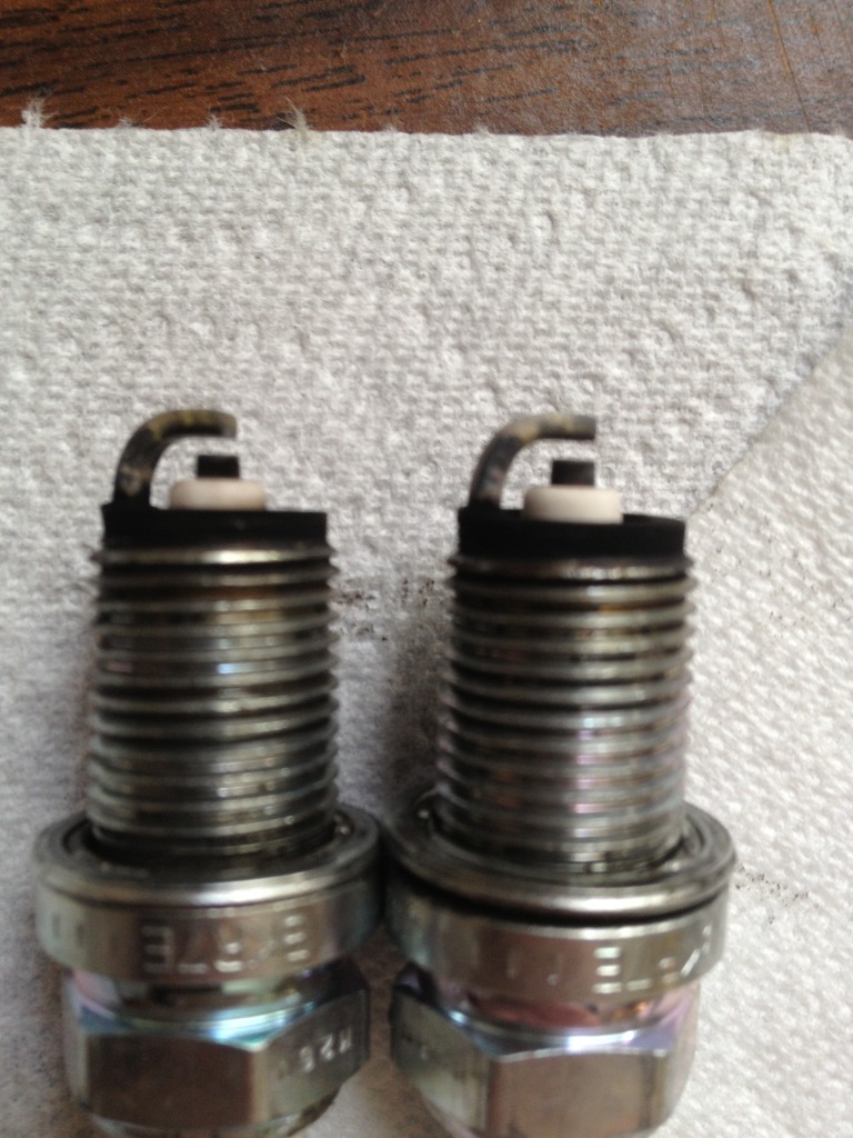

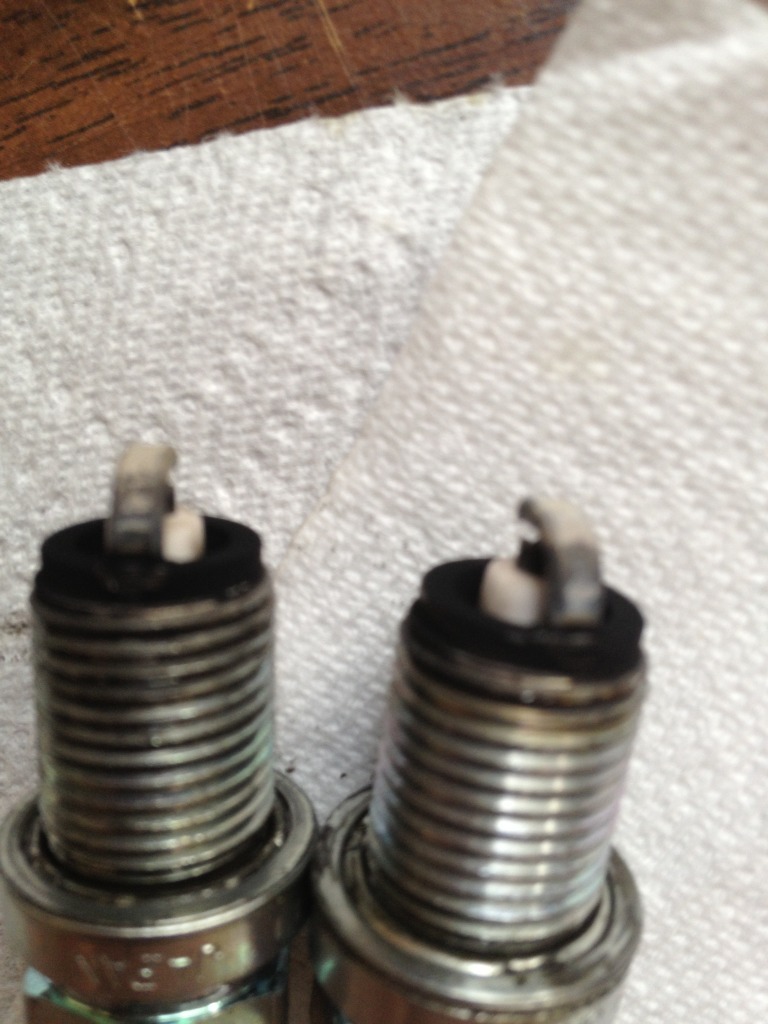

Second two are from 2 and 4

Plugs look pretty damn good to me. Were they wet when you took them out?

Plugs were not wet but the car hasn't run in 12 hours, the coils and plugs were tight. How exactly do I clean injectors? I want to take them out and do them not use techron. What's the most effective and easiest way for a regular dude to clean them correctly?

Gapped the plugs to .028 inches, they were all between .034 and .038. Started up but I still think I may have a fuel injector problem, anybody know the est way to clean them without and other those rigs people uses with the switches?
That might not be the only issue, but it definitely wasn't helping. You should feel much better response from the engine.
Wow didn't know the bkr7e went all the way to .038 without being compensated. Definately needs to be around .028 (or less). I had mine all the way down to .022 to stop misfires before I decided to upgrade to 2.0 ignition.
