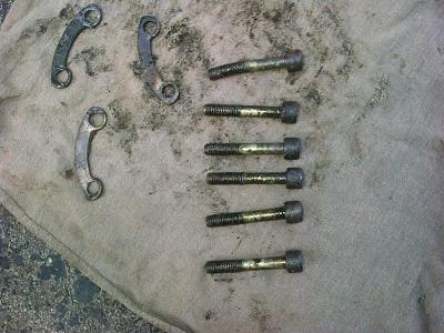

I don't comprehend how this could happen... was driving smoothly down the road, hit a small bump or two going slowly through an intersection and then heard some nice grinding sounds.
Pulled over to see the rear left axle came off the diff somehow, and picked up all 6 bolts off the road. None of the bolts were broken or stripped, one was bent. They still thread into the flange, its not stripped out.
How could all 6 bolts come out at the same time like this?
Attached Thumbnails Axle bolts fell out??-st.-catharines-20120905-00659.jpg   Axle bolts fell out??-st.-catharines-20120905-00660.jpg

i suppose its possible. have you had any repairs done in that area recently?

Posts: 271
From: North East PA
Most likely they weren't installed properly, bolt retainers left out or bolts not torqued to spec. Could also be that the wrong wrench was used like an allen key in place of the german 12 point type. The allen key seems to fit properly, but when high torque is applies it strips the inside of the bolt head.

Posts: 1,900
From: CT
They were likely not torque properly. Replace all the bolts and torque them. Make sure the threads are free of grease before install

Posts: 1,272
From: Minnesota
The boot on that CV joint looks pretty strange...like it's all twisted up. Is that OK?

Joined: Aug 2011
Posts: 2,380
looks like the joint popped out mtroxel, your def right its twisted and it shouldn't be.

Posts: 3
Yeah boot is def twisted up, gonna try to get the axle out today but don't have all my tools here...

Posts: 7,225
From: Wadsworth OH
If the axle is still good you might able to get away with just replacing the bolts and the boot. We have repair kits below.
