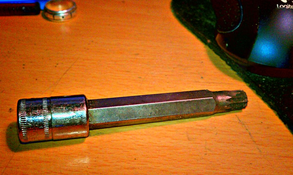

i have the snapon one, got it from a truck when i didn't have the right tool and flagged him down in front of my house (thank god lol). he never charged me for it. he said he'd come back, never did. oh well. it was expensive too, like 40 bucks or something like that. it says "10 ftsmiole" on it.

Should be an m8. Auto zone seems triple squares in a kit from m6-m12

The axle bolts are M8 triple square. Some of the non-OEM replacement bolts sold by ECS and others are 7mm allen heads.
