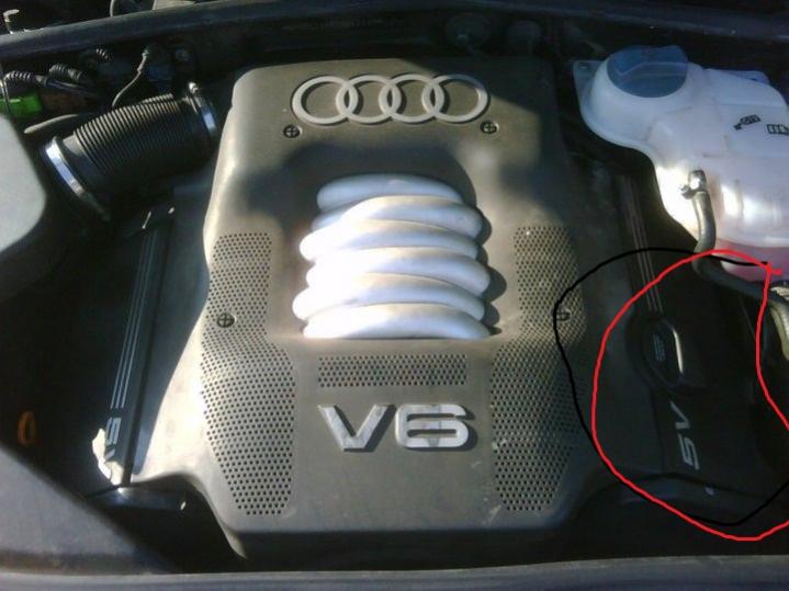

The smoke looked like it was coming from the right side of the engine, around here (see attachment). It was between the engine block and whatever is next to it, not the oil cap which appears to be circled.
ok yeah, first thing i would do is check the fluid reservoir, see if the P/S pump whines a lot when you turn the wheel, and check for leaks in that area. The reservoir is just to the right of where you circled and there's a lot of lines in that area. You could be leaking P/S fluid onto the header on that side, makin the smoke.
A hiss is normal at lock. A squeak when the turning the wheel is most likely the control arms, even if you arent moving. Power steering related is usually more of a scream or chirp I would say. Look at the seams of your engine and see if oil is seeping through them (if so, its likely your valve cover gasket, and my bet if you have smoke that smells like oil coming from your engine bay, although it looks like you have a V6 and this is more common the 4 cylinder).
