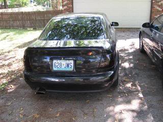

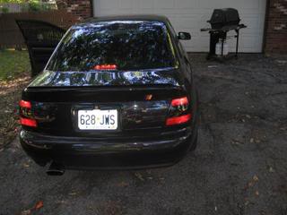

there you go
just get a can of rc window tint
if you were near stl, mo i would do it for you....... i have done about 5 cars

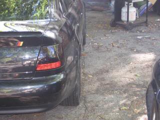

film looks like **** after a little while, but at least you can always remove it. i used VHT niteshades. just do even light coats until you get it the darkness you like.

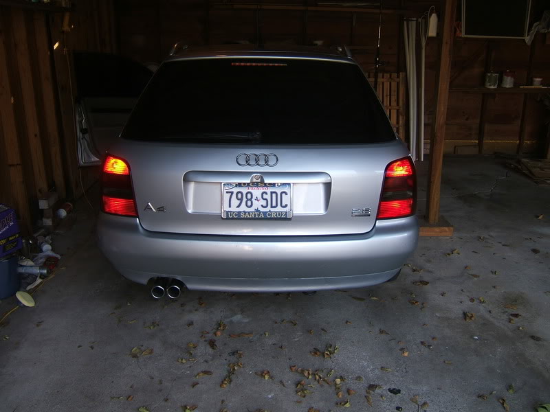

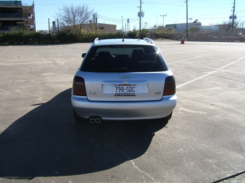

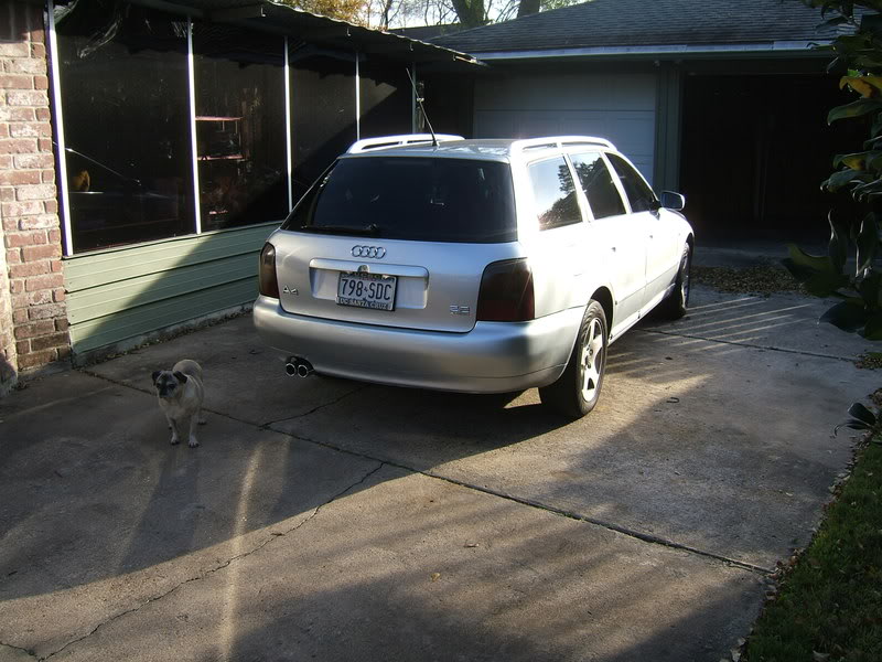

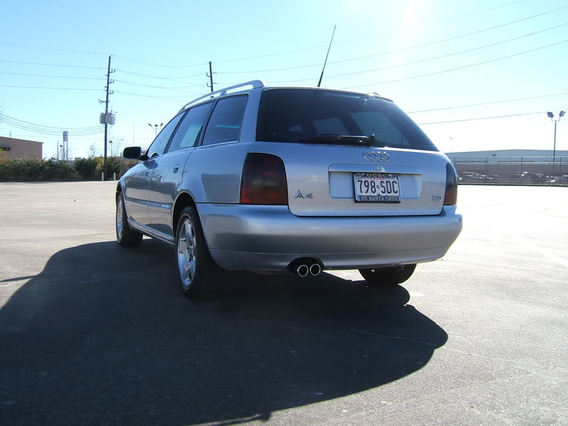

This DIY is long. I sanded mine as in the DIY, got them good and scuffed up looking and then cleaned them really well. As has been said, do very light coats and be sure to use clear coat when you have your desired darkness. I don't recommend sanding after the clear coat.
