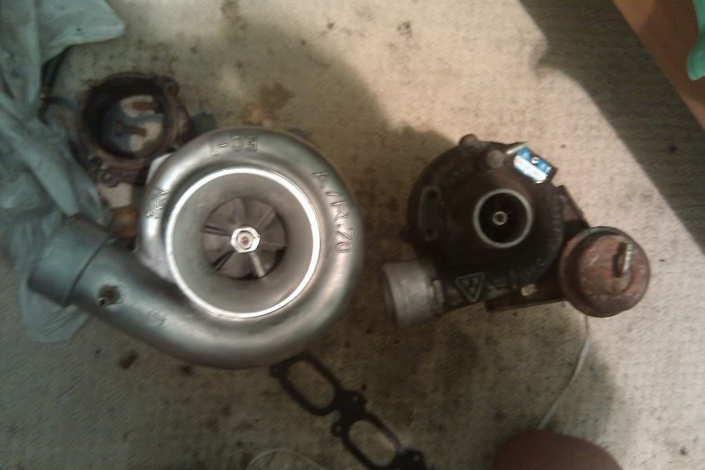

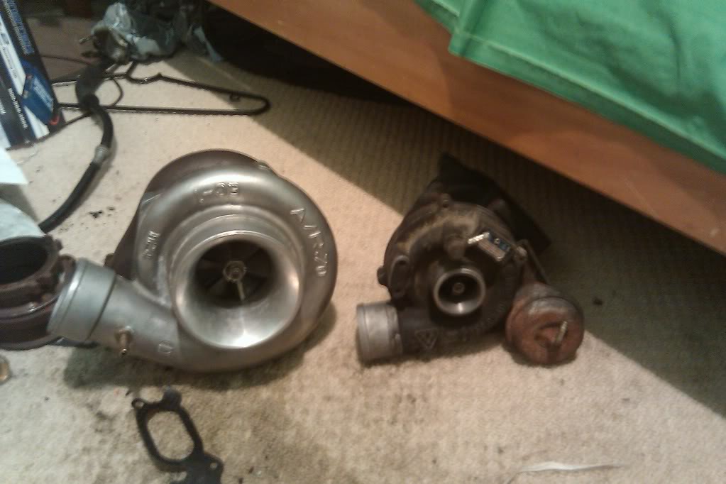

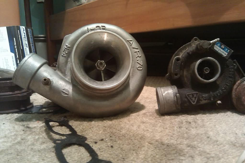

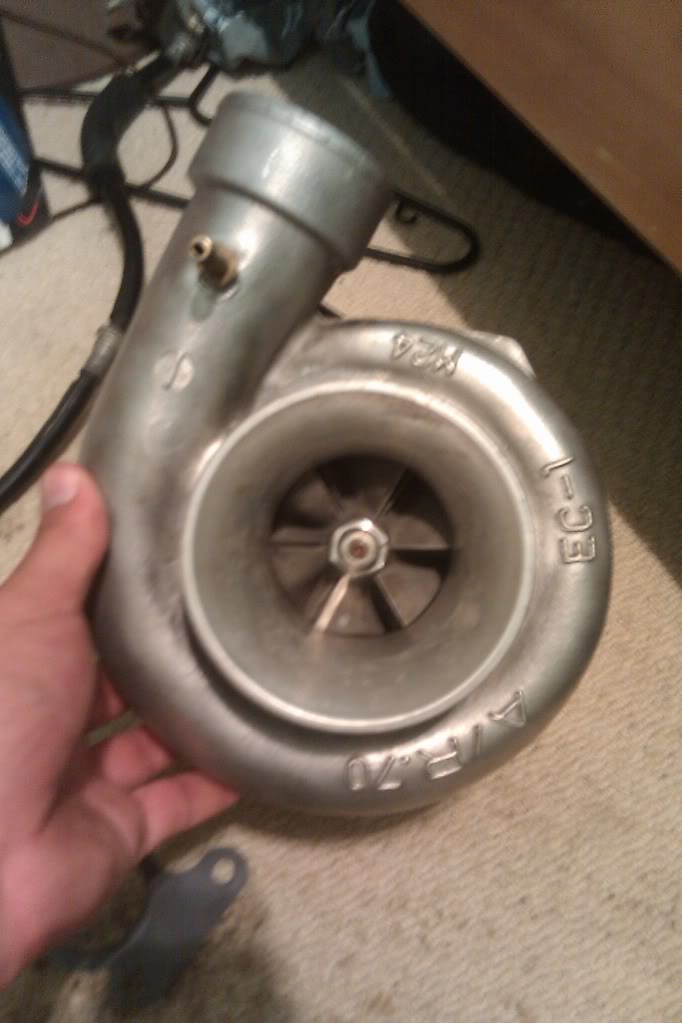

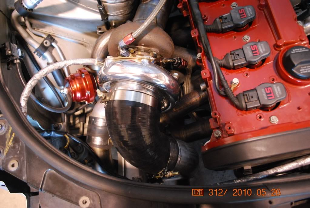

Yea I sold the t3/t04 and grabbed another 35r with a .82a/r this time instead of the .63. Thing is immaculate and I got it for a steal. Tweaking a few things and getting ready for WaterFest. Here's a few pics of the new turbo. Yea that's a k03 lol. Look at the difference in compressor inlets

There are 4" to 3" hoses, but they wont have any fittings on them. You could use one of those and then do 3" pipe to the maf and put the fittings you need on that pipe. I have seen a few people do that for the Full-Race setup.

I just got a hose something like that from 034, but mine was 4" on both sides and just a 45 deg bend.
Here is their 90 deg silicon hose

Yea I should've been more clear. Do you think the bend would clear my headlight? It is a facelift headlight so there's more room than the 2piece ones.
Old Jul 14, 2010 | 11:43 AM
  #69
Mike-2ptzero's Avatar
Joined: Apr 2008
Posts: 3,274
From: Phoenix, Arizona area
Should clear, IIRC the Full-Race manifold points the turbo inlet toward the headlight more then the 034 manifold. So you should be able to clear the head light, the one in the picture is of a B6 which has bigger headlights then the B5.

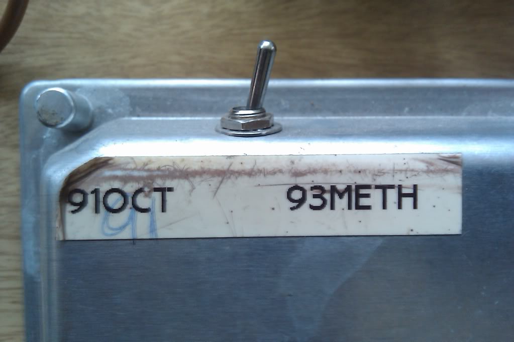

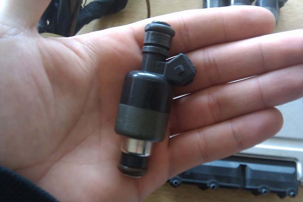

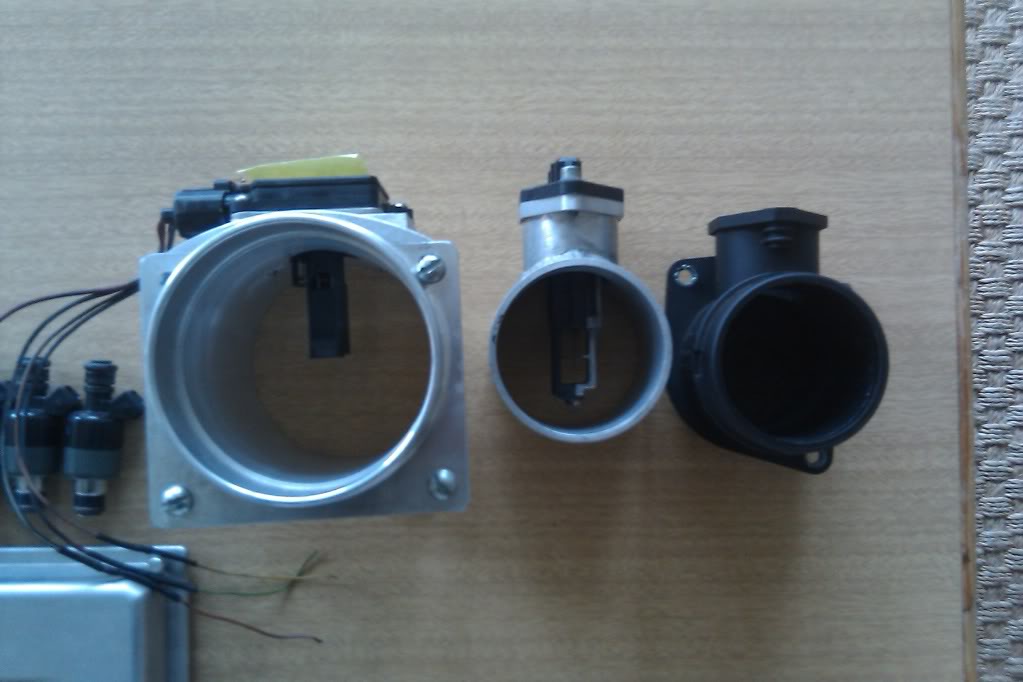

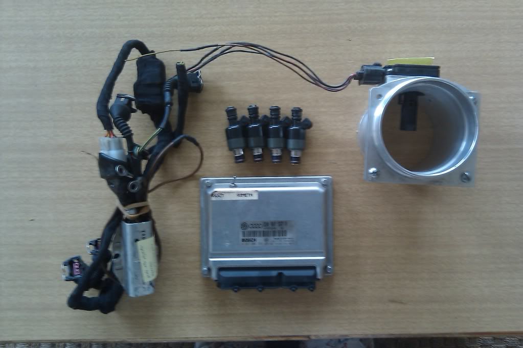

New computer and fuel setup.
Chris Tapp 1000cc ecu with 2 files... 91oct and 93+meth w/ toggle switch.
SCT 4" "lightning" MAF
Siemens 1000cc low impedance injectors

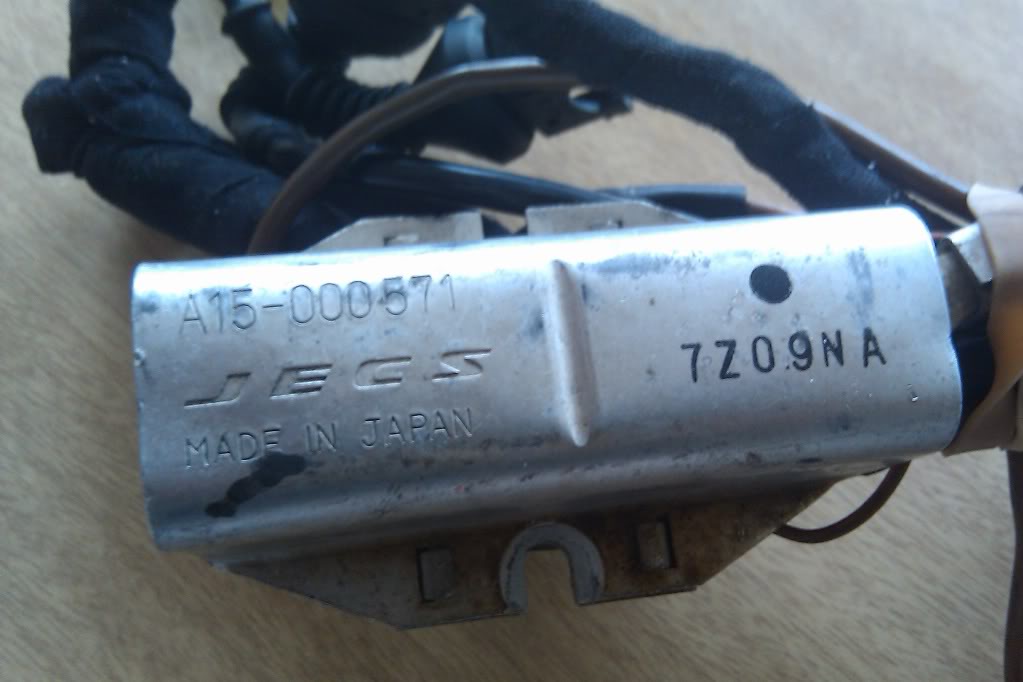

Resistor box with full wiring harness for the injectors.

Stock, VR6, and big Lightning MAF
