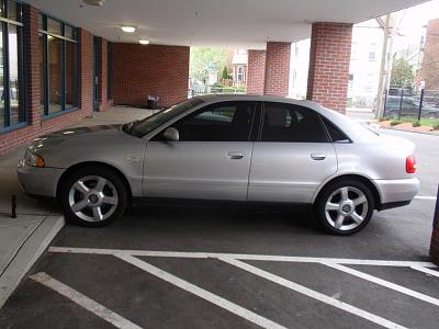

It means,your brake pads need to be changed in the front,where the sensors are,which might also mean that your back pads,need to be changed too,thats if you change the back and front,at the same time.
I changed all 4 rotors and brake pads all at once about 2 1/2 weeks ago,got the best grade autozone had to offer,was expensive but well worth it in the end,life time warranty for the front and back pads and 2 years on all 4 rotors ^_^
