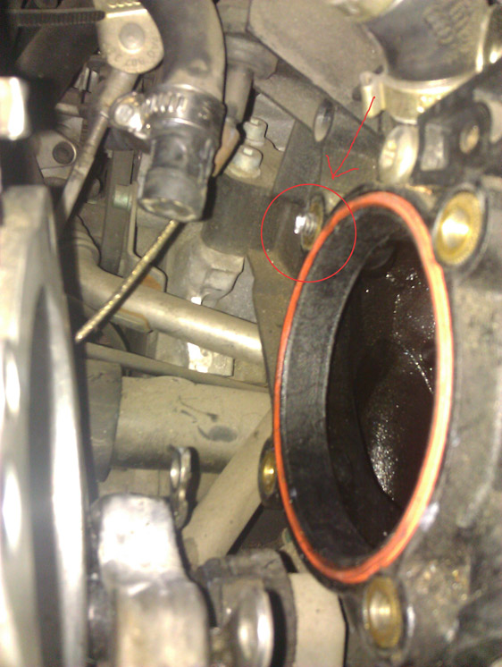

so i decided to clean the throttle body. Was pita but i got it. Cleaned it. when i went to put it back together, i tried tightening the bigger of the 4 bolts (the one that has another bolt go inside of it) and it snapped in half. the good news is that there are few threads left . the bad news i cant drill it out or nothing cause its in the back and there is no room. What do you guys suggest? Im really worried, just bought the car few weeks ago.

Here is the picture of it..

Probably have to pull the intake manifold and drill it out on the workbench. Welcome to Audi

the screw is going straight into the engine. How hard would u say the job is to take one out?

Get a small set of vise grips on the protruding piece of bolt and turn it out like 1/4 turn at a time.

That was my first thought when I saw the pic...

sweeeeeet! thanks fellas! no need to take manifold out! I just went to home depot, bought some vice grips (better than pliers!) and after few min and doing like u said quarter turns, i got it out! now if only i knew where to get the new bolt!

Make sure when you get the replacement bolt it's the right quality of hard metal, or you're going to be a sad panda again
