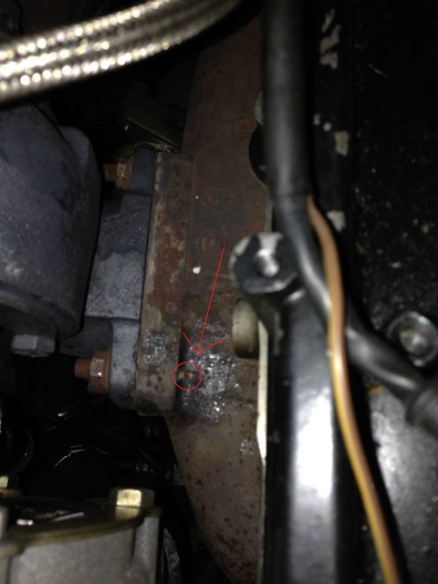

Figured out a large part of the problem! Where my turbo bolts up to the manifold the nut was missing on the stud.
It was like that on the other side also causing the whole bottom side to leak exhaust out.
