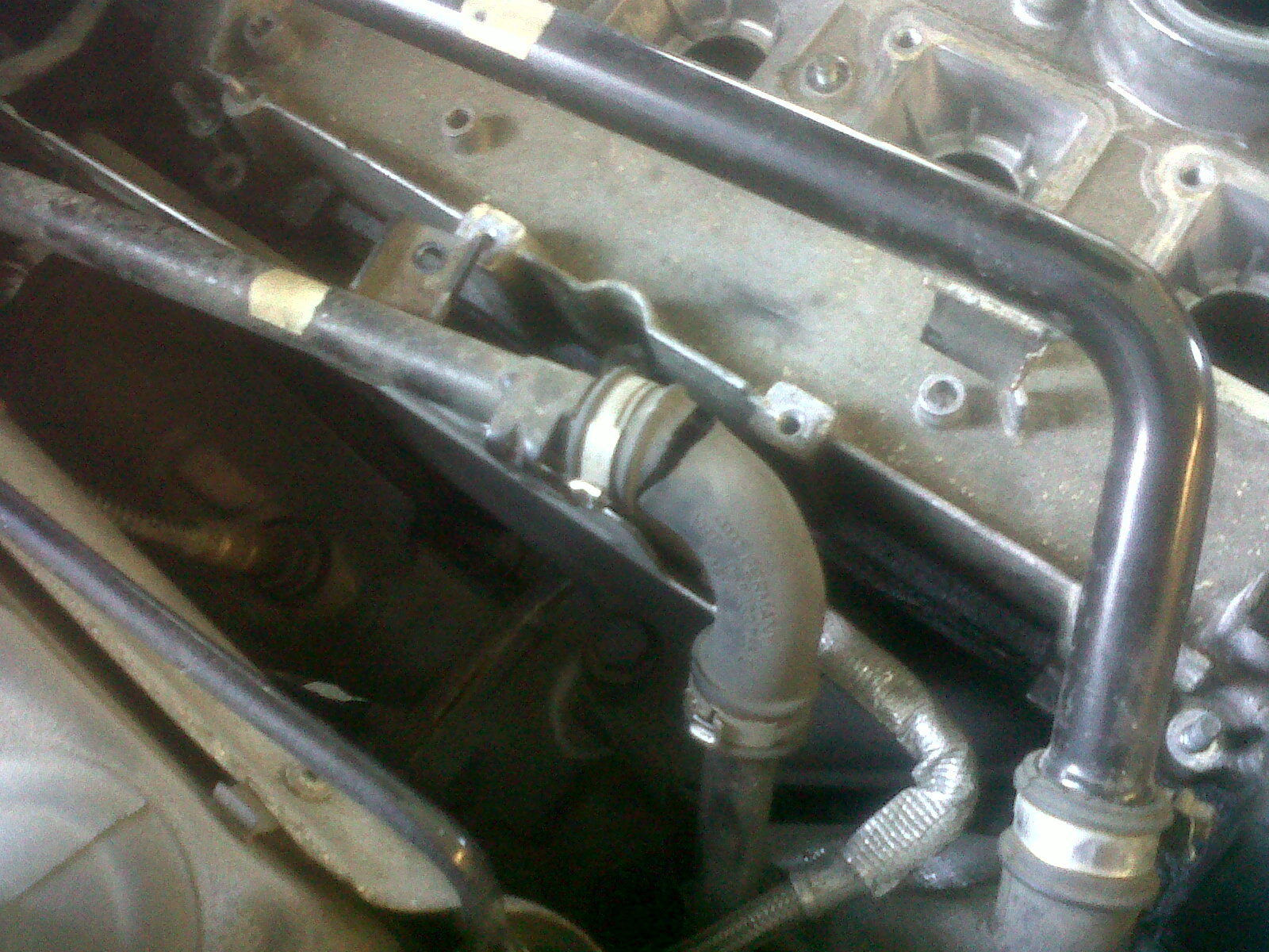

I just remembered that this hose is cracked:
Could that be causing these codes?

The broken pipe can cause the AIR code, but it should not affect the KS or the O2 . The AIR does not affect engine performance and the AIR pump only operates till the cat is lit. A bad KS could cause engine damage, and the O2 could cause economy and performance problems.
Old Oct 2, 2012 | 10:45 PM
redline380's Avatar
Legal Moderator
Joined: Oct 2008
Posts: 1,975
the bad secondary wont be anything bad. sensor 1 is the one you need to worry about, although you wont pass emissions with a code like that. it would need to be fixed if you have emissions. the secondary air injection code is most likely because of that broken pipe seeing that pipe feeds the secondary air system. as for the knock sensor code, i got no idea besides a bad sensor, unless of course you have been knocking badly
