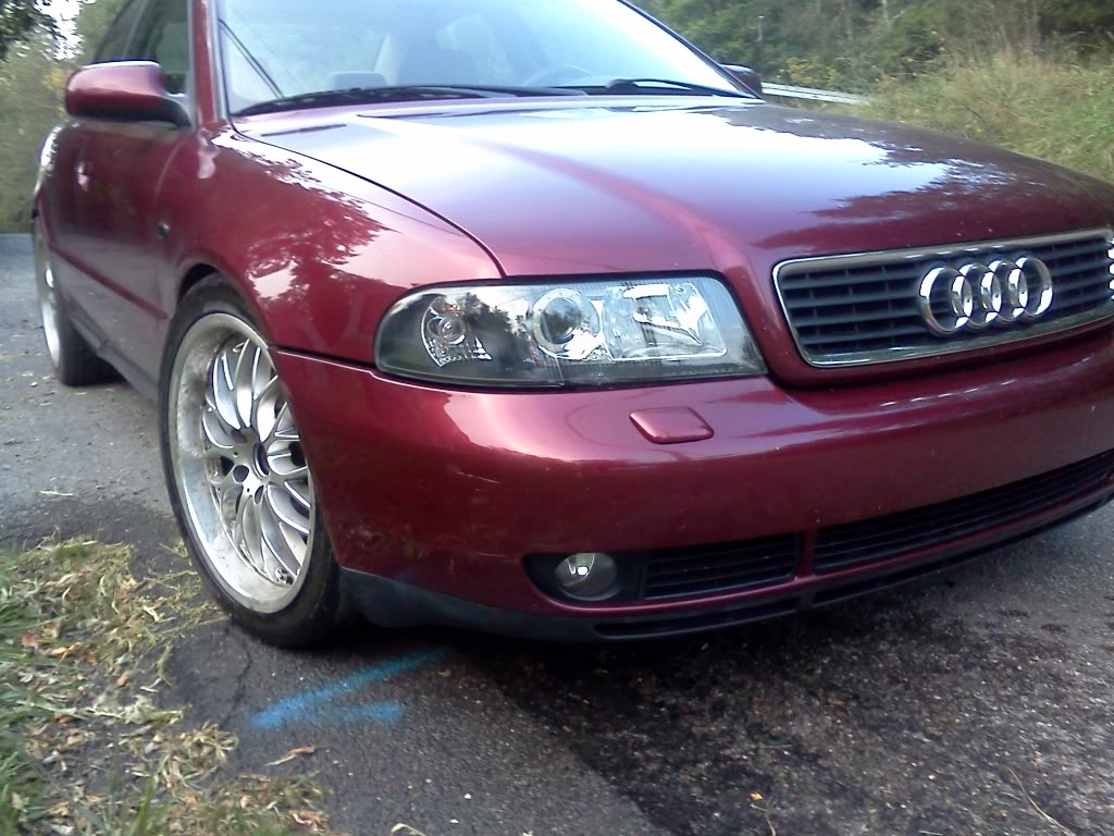

I've got Eibach shocks + springs. Ride height is perfect (for me) as seen below, and the ride is nice. Stiffer than stock, but not uncomfortably so.
