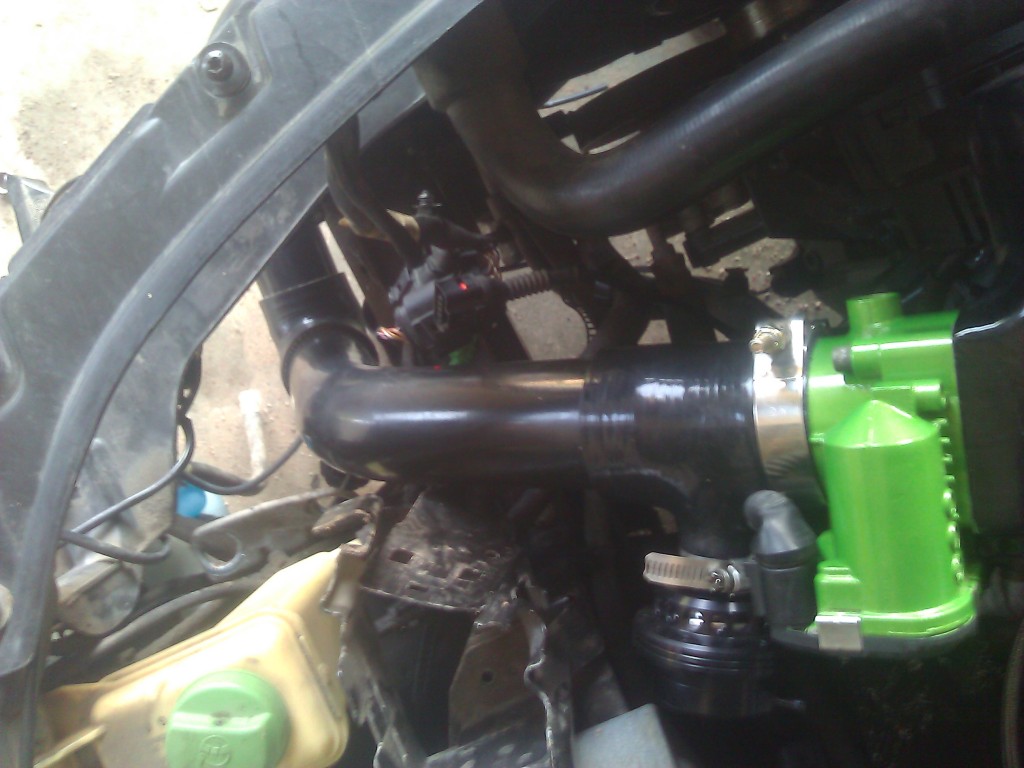

yeah running a bov at the throttle is actually much better. the air is instantly blocked by the throttle plate and by venting it there, it doesnt back all the way up to the stock dv location. heres my location. all youd have to do since youd run a dv is run the vent pip back to the intake. i obviously dont have to do that.
