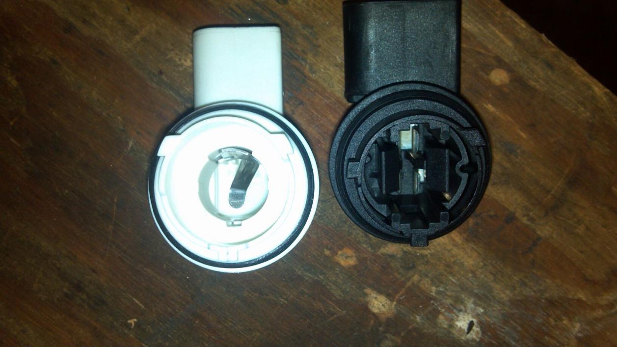

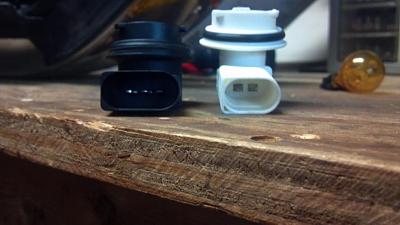

yeah i was hoping that they would be plug and play but of course it cant be that easy! here are some pictures to help you guys out, the plug for the headlight looks the same, slips on but as you can see when i try to clip it they cath, thats why the plug is all chewed up on the depo, and the corner lights are just completely different, it looks like the new ones may use only single filiment bulbs. which doesnt make sense because i have DRL's

corner light holders (white is depo, black is valeo)

The turn signal holders are direct replacements. See the three clips on the edges that form a sort of triangle? The white piece should literally slide into place just as the black piece slides into place.
For the housing plugs, they should be a direct fit as well. Maybe the depo light connector has a defect or the wire prongs that stick out aren't aligning correctly when you try to connect them. That's weird

yeah but if you look at the corner light holders, the prongs on the side are placed differently. the valeo wont go into the depo, and the depo wont go into the valeo.
i just talked to ecs on the phone and they said that there was a split in 2000.
they are putting together a set of harnesses. there goes another 150$
this makes me livid. they should have mentioned this in the description so i could have figured out what i needed before i ordered them!!!
