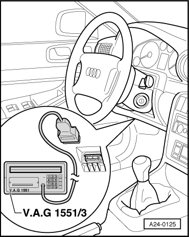

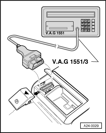

Anyone can guess as to why you have a CEL, but you MUST have the fault codes retrieved from the ECU with a scan tool or laptop diagnostic software (Vag Com) to pinpoint the cause or point you in the right direction. The OBD port is under the dash on the drivers side, and in some cases in the back seat ash tray panel.
