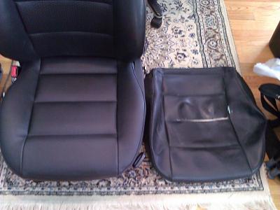

After 10 long hours, my seat is done... but done right!

Nice job , looks great!

Great Scott,Batman!! that seat looks brand spankin new!
