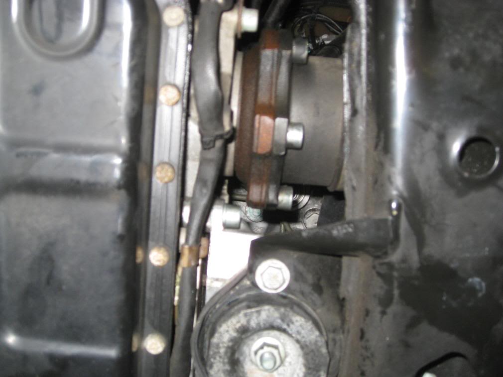

The passenger side wasn't too bad. It was the driver's that drove me nuts. I think because I have just an oil pan instead of solid metal to jack up on thats what made it harder. But I ended up just pushing up on the cast iron piece coming out of the trans going to the cv boot.
Doesn't matter, its in now.
