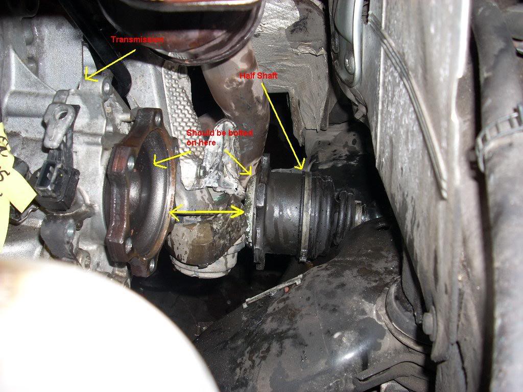

so when you rev the engine while the car is sitting still, the speedometer says you are moving?
check all your half shafts (shafts that connect the wheel to the transmission) every once in a while someone has one fall off, and when that happens 100% of the power is sent to that wheel with the disconnected shaft and you dont move. sometimes the bolts fall out, sometimes the shaft can snap.
edit: like this

Yep, found a half shaft problem. much cheaper than clutch. thanks for all the responses.

The half shaft splines were stripped in the hub. ever heard of that? I had changed the outside boot 6 months ago, and torqued the collar bolt down right, I thought. New half shaft, $300 later, on the road again. out of town so had to pay the man.
