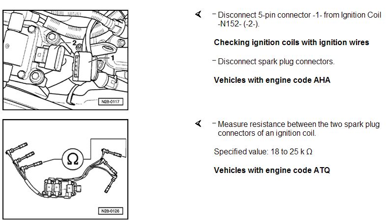

I looked here, and they tell you this:
Ignition Coil Power Output Stage 2 Electrical Malfunction
Audi OBD-II Trouble Codes
