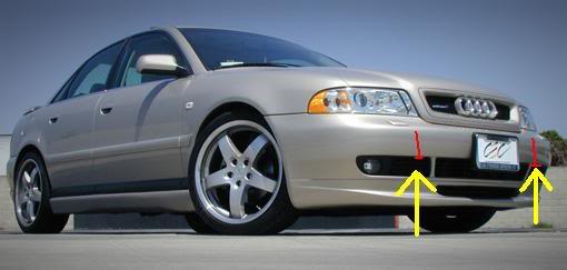

is it the torx underneath the headlight one in each side or the two ahead in each side
Old Aug 7, 2008 | 06:50 PM
ghost6303's Avatar
Joined: Oct 2007
Posts: 2,158
From: CT
they are here, the red lines = the bolts, the head of the bolt is on the bottom, you remove them from the space where the black trim comes out.
