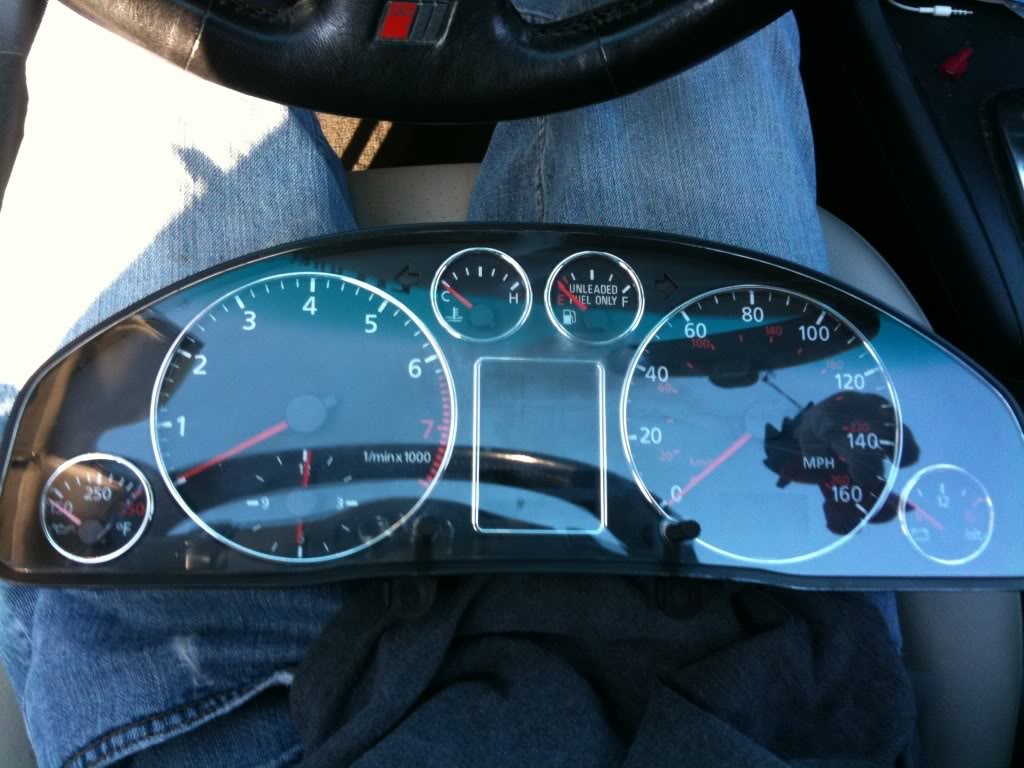

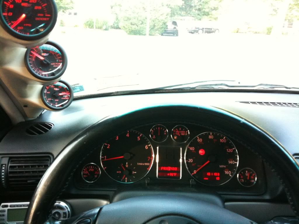

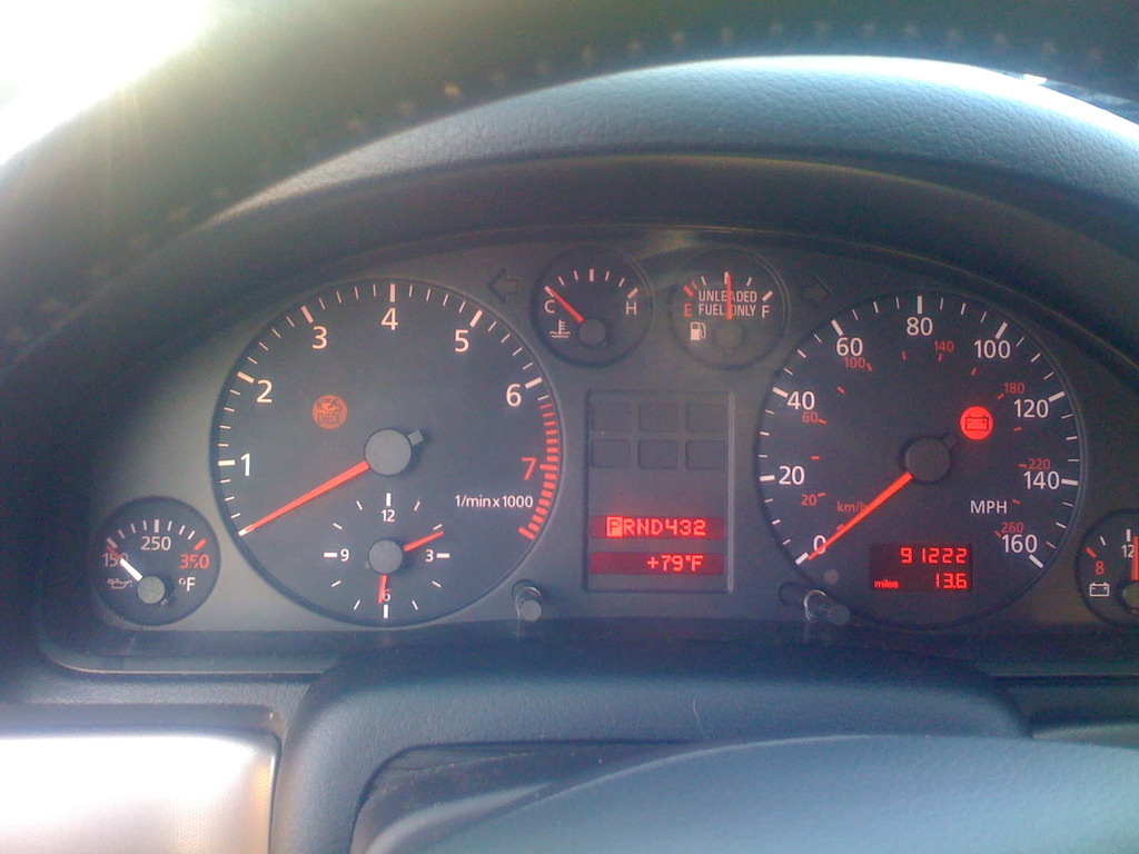

got them in the mail today and installed them in about 10 min.. they came out pretty nice.
before
after

It adds a gloss that looks much newer. Great work! now you need to find/fab some for your gauge pod.

The whole process takes about 30 min. The removal is easier than installing the rings. 2 hex screws then 3 cables behind it which are easy to unplug. The ring install took most of my time the top 2 for the temp and gas gauge were the hardest there's no room to get your fingers in there to push them down so I had to use a jewlers screwdriver and press down on it with that. Then the LCD surround is glued on so I had to line that up by sticking my fingers thru the speedo and tach holes.. The cluster is so easy to remove I'll take a video and some pics tomorrow
