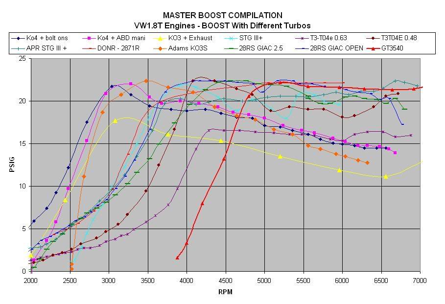

right out of the newbie guide... try reading it when you have time.. if you haven't already

^well you can stick that back in the newbie guide and go back to answering the question
The question is for torque #'s and HP #'s and you post up a graph showing PSI and RPM.
Old Mar 29, 2009 | 01:49 AM
Jc61990's Avatar
Posts: 3,326
From: Long Island, New York
Old Mar 29, 2009 | 03:00 AM
