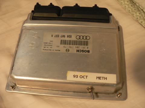

I guess my pm never got sent. Tapp will make you a tune and you switch from pump to meth with a toggle switch on the ecu. Looks like this

so would i have to send my ecu out to them i am guessing that would make sense. you also said i should talk to my revo dealer to see if they have a software for a gt2x correct? so basically there are a **** load of software choices
You have plenty of options. I think it would be wiser to get a appropriate tune more than try to save a few bucks, exspecially since you dont have a stock wbo2 or ability to use lemmi
