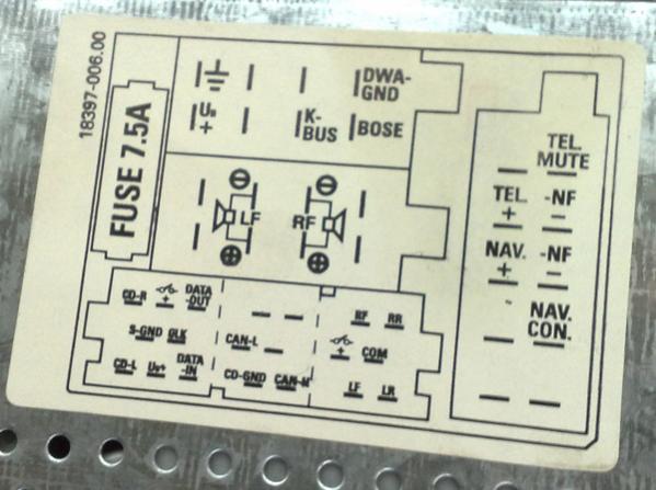

Brie, I'm assuming your ORIGINAL worked fine right? the wiring diagram should be on the bottom of your original stereo, I'm attaching a diagram anywho....
About the missing plugs someone mentioned, you should actually have 4 different plugs that plug into the back of the radio......

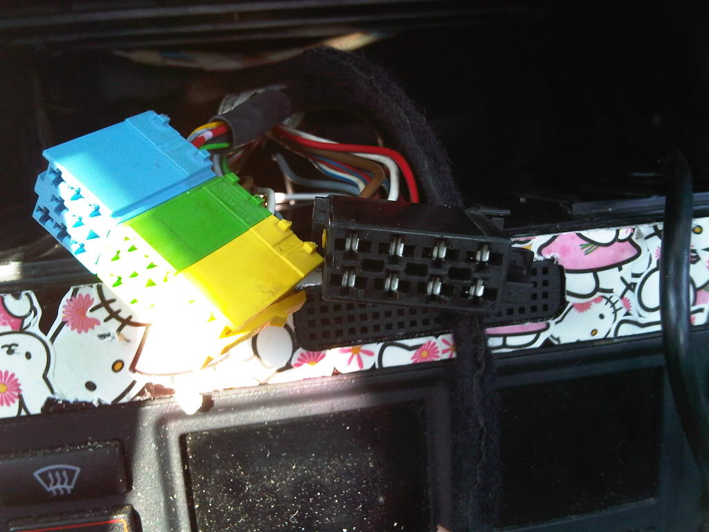

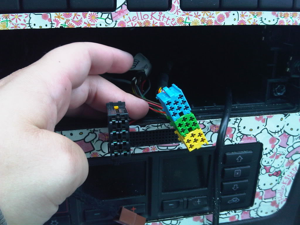

If we're talking about the same radio, and according to the diagram, it seems you are two plugs short somewhere?? did they fall in the back? you are missing speaker wires and ground wires.....the dash isn't that hard to take out.....if you want directions, let me know....
