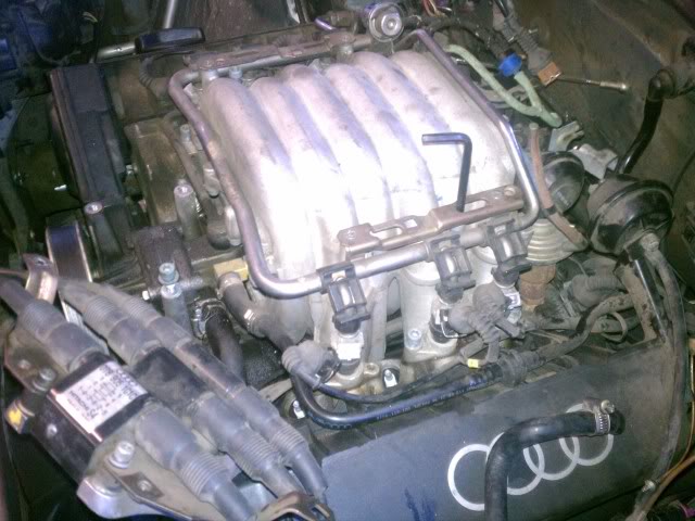

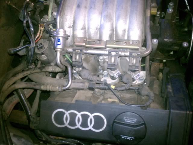

ok time to take off the CIA

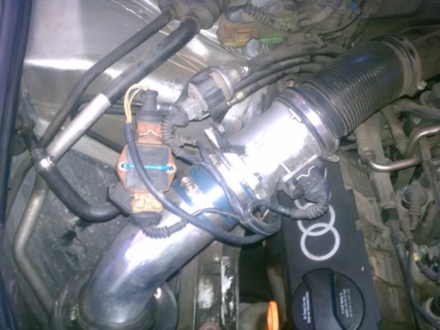

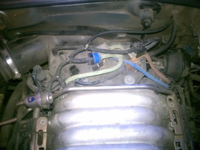

heres a pic of the vacuum lines from the top, DONT forget about the line that goes from the TB to the bottom of the air duct! ohh and ill be replacing these lines as they are ALL just FUCKED UP! make sure you do the same

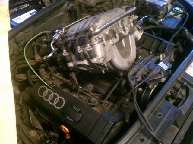

ok, now the duct is off and everything is pretty much straight forward.
And lift off.. im not completely removing the IM.. im trying to save as much time on assembly, and right now im only doing the pass side... so yea

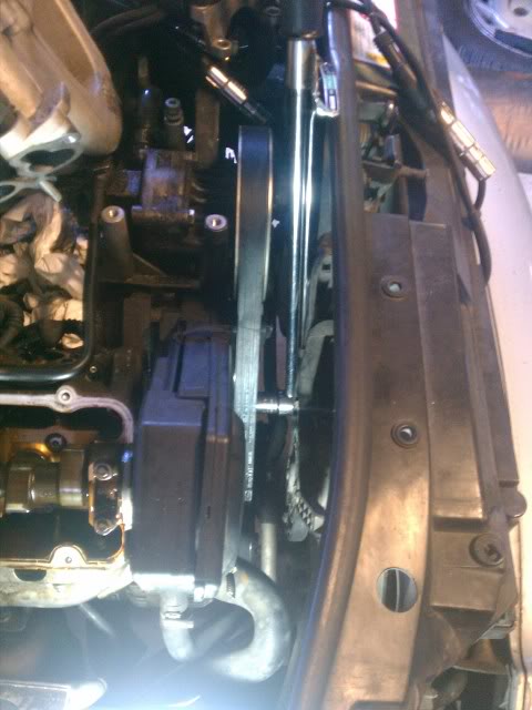

ok so for anyone who needs to replace the serpentine belt.. ALL you need is a 6 point 17mm and a 3/8 breaker bar, if you dont have it, like me, all i used was a 17mm 1/2in drive OLD (used as a breaker) torque bar, non click style and it sliped right on.. turn to the right, and bam.. serpentine belt falls right off.

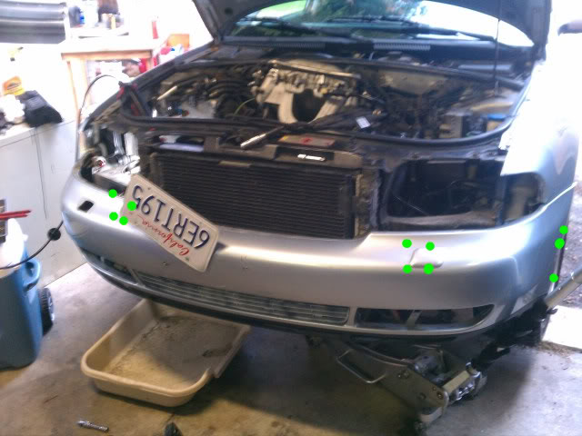

next, there are two 10mm bolts that hold the nozzle (dnt know the name.) onto the bumper. i used a universal, and 3in extension with my mini ratchet. once BOTH sides are done, simply use a flat head and take the lil covers off by simply prying underneath (in the middle) side to side. once done you will have access to the torx bolt that holds the bumper on. and then move on to the fender wells and remove any screws retaining the bumper to fender wells i believe 3 screws. then simply giggle each bumper end and it should come right off the clip. (one on each side)
i put a green dot on most bolts, this is just for refrence, make sure you disconect the hose going to the nozzle under the bumper, it looks just like a fuel line
then simply pull and this is what you will get

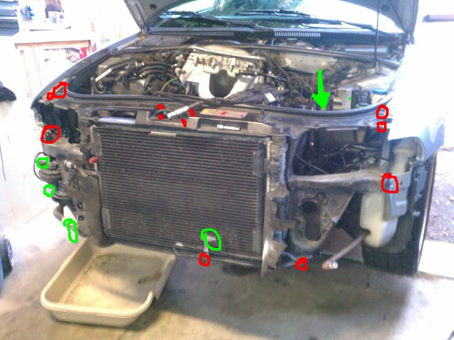

ok so below i labled the pic, the GREEN is Electrical conectors that you must unplug, (including the A/C lines that you must undo,) and the RED is bolts i came across

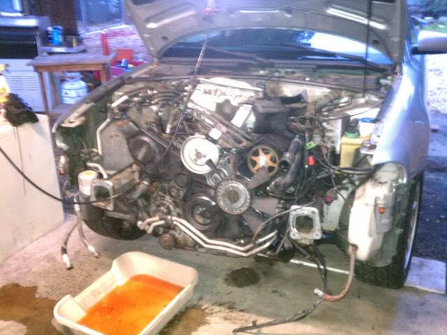

If you have a friend that can help, that would be better as the clip is kinda awkward, Inmy case i just left two bolts up top to hold it into place an i had to double check everything, you need to take off your hindge too! Just make sure you disconect the ambient temp, sensor that i circled in green,
Once done, your b5 will look like this

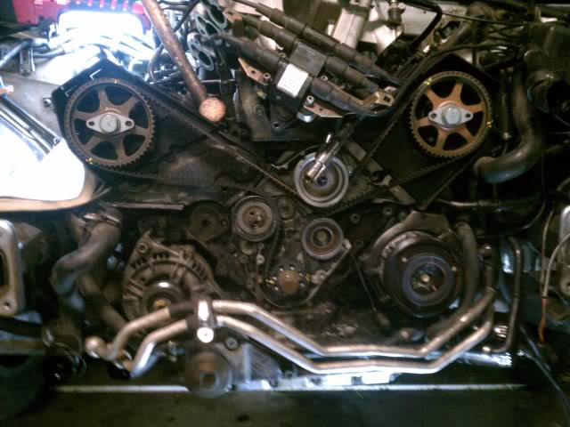

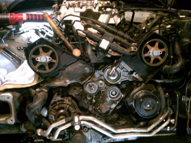

everything else is pretty much straight forward. now wen taking off the timing belt, if your goin to reuse the belt MAKE SURE YOU MARK IT! now, im ONLY reusing the belt because it has 190 miles as with the water pump and serpentine belt.. THEN the heads blow.. lol so yea i think im good.
before the belt removal
After

You won't remove the intake manifold to save time....? But you remove the entire lock carrier assembly....?
All you had to do is what we call "tipping the nose"
And thats remove all the bolts and let the thing hang forward resting of the edge of the nose mount.
Now i'm assuming you didn't break loose the cam gears...? Cause if you did the timing marks would be pointless. But the reason to do so. To properly take up the slack after releasing the tension. Ive never done it the way you are, And i've heard nothing but nightmare stories from people that do. But from a mechanical perspective it is possible, But just be careful to turn the engine over by hand after you have the belt set. Any resistance other than compression. Stop....
Goodluck
