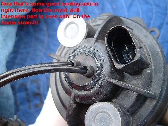

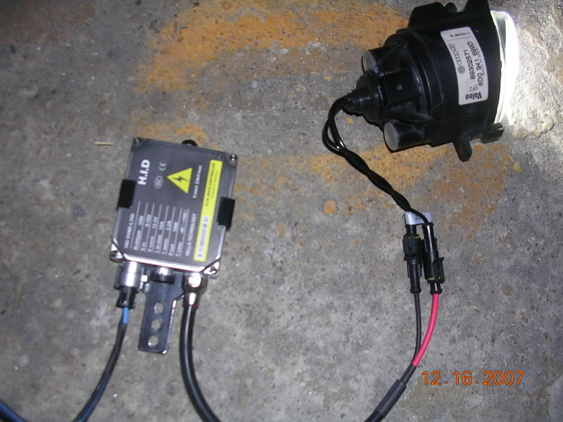

I just got my VVME kit yesterday and was looking through the install diy's and notice my kit for the bulb has 4 wires coming from the grommet and bulb. All the DIY i see only have 2.
The instructions that came with the kit say to plug the extra 2 wires into the original harness but they are only spade connectors. So do you think I should simply cut those 2 spade connectors out and then splice the original harness into the power plug of the ballast?

Nevermind, I went through and once I opened it all up it was clear. It seems as though VVME has updated their wiring and now the spade connectors simply clip into the stock harness inside the fog light bulb. I never had to splice any wires which was nice. As far as a result, HOLY SH*T, these are brighter than my OEM Xenon's and are awesome! I can't wait for it to get dark out...
