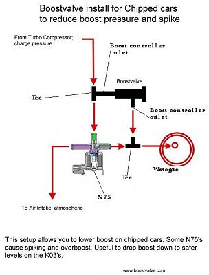

Can somebody explain this diagram they use as instructions? No title
I wish they would label the parts...
what do you need to know about the diagram? i added some descriptions.
