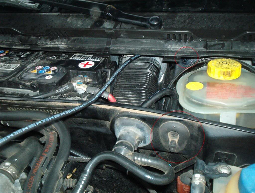

Do either of you guys have a pic of that location? The one beside the battery? Because I cant seem to find it... Do I have to move the battery?
The only location I can find is the one behind the ECU... -_-

Someone already posted a picture of it for you. You just need to remove the windshield wipers and the covers below them to really see it and to work on it.
It is inside the red circle which is just to the left of the brake/clutch fluid tank.
The 2 red circles are where the stock Throttle Cable runs on the ndbw cars.

Oh ok you guys were both talking about the same spot. Yeah I just looked there and that seems like a great spot to run the wire. I think the 0awg is a bit big but I can modify it.
I'm afraid the edge is going to cut into the wire creating a mega short. What did you guys use to protect the wire going through there?
Thanks

You will need to make that hole bigger, you can then put a rubber grommet in it and then the wire.
