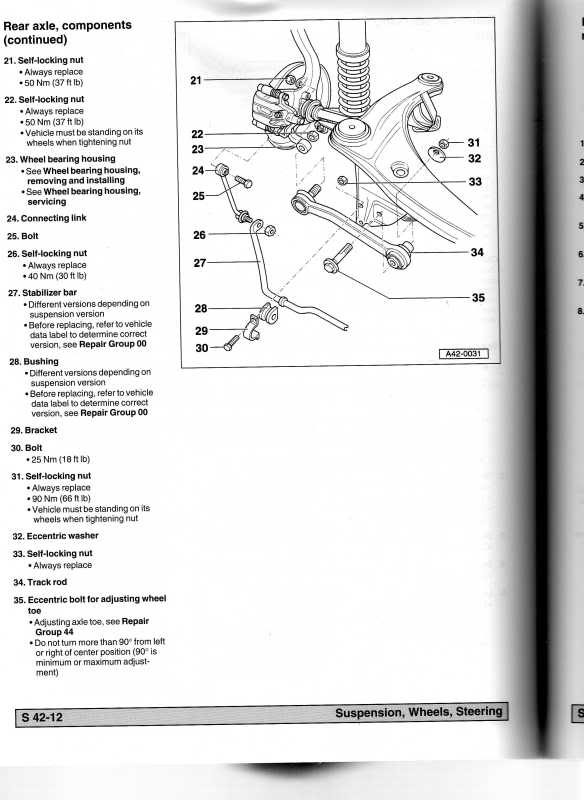

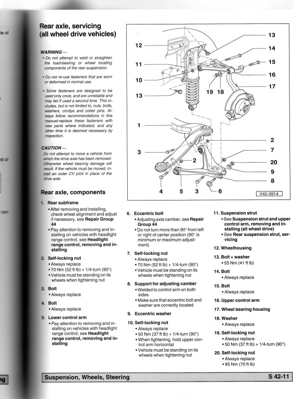

Wasn't sure which ones you were asking about
so here are a couple scans of a bentley manual
