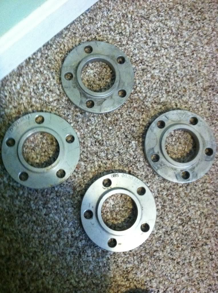

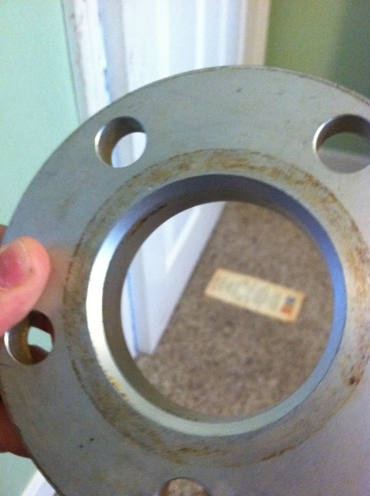

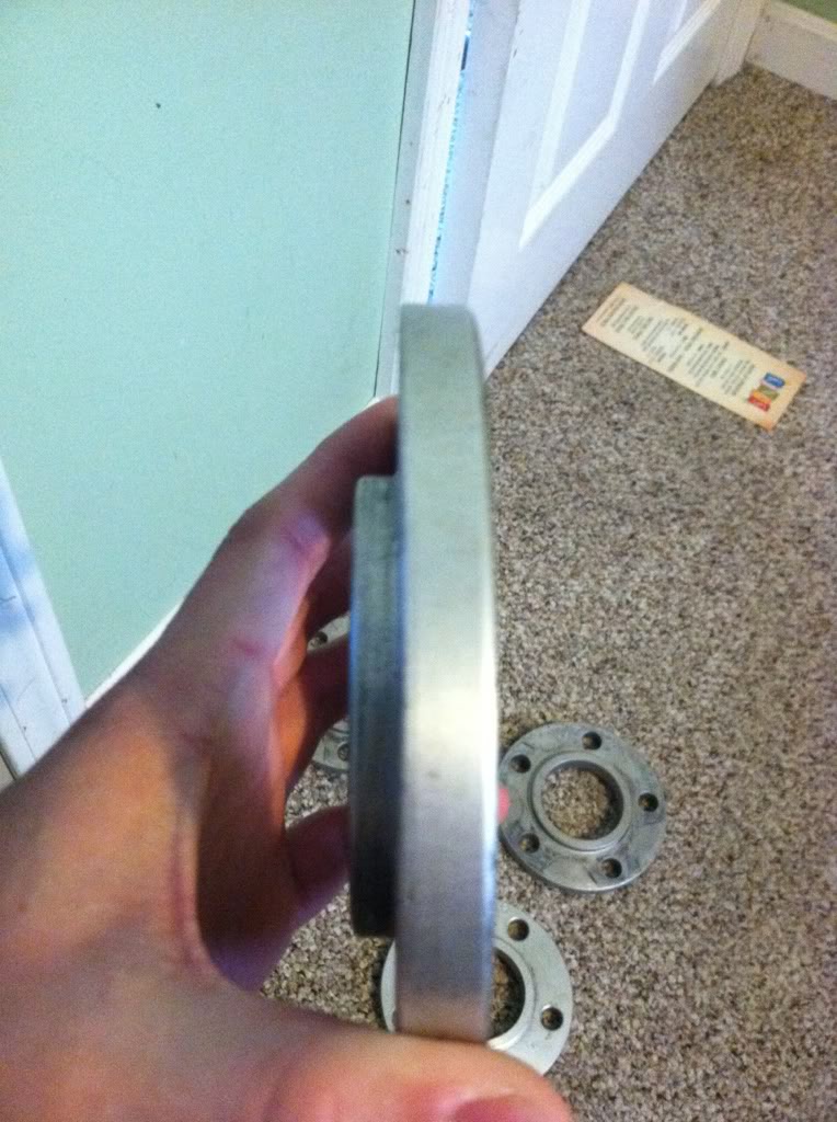

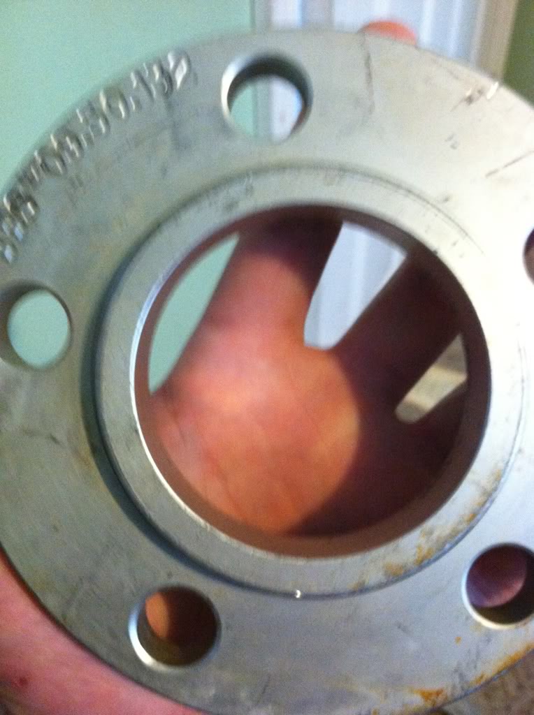

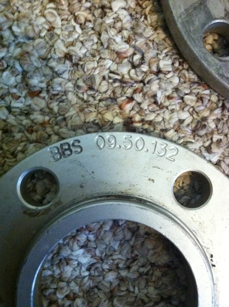

Forgive my retardedness. The guy gave me these with the wheels but i think my lugs were to short to tge wheel and these on or just forgot i had these. he said they were spacers. Name:  0898b251.jpg

I know hubcentric rings are supposed to be more like this : http://www.google.com/imgres?imgurl=...PUBMAY&dur=367
But these look almost like adaptors and spacers combined? Or am I just confused and if you get spacers you dont need rings? Im new to all this stuff so any help would be appreciated. Do I need longer wheel lugs/bolts to put these on?

Those are hub centric/wheel centric spacers. Looks to be about 10mm, get some extended bolts if you want to run those.
