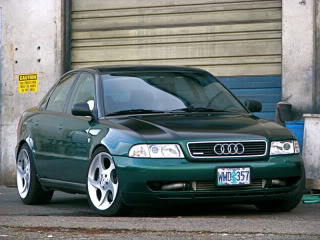

The mods consisted of
144,000 miles on Body and had 132,000 on clock when engine was rebuilt.
Engine/Trans
1.8t with intergrated engineering forged rods and JE pistons
Precision 5857 billet turbo with about 7k miles on it.
tail 38mm with 13 psi wastegate spring
stock fitment adjustable fpr.
fuel pressure gauge
all new belts
3" downpipe... forget where its from
hallman manual boost controller
greddy fmic
forge Diverter
ATP software
550 injectors
Milltek 2.75" exhaust with deleted cat.
low mileage (approximately 110,000) replaced 5 speed transmission
southbend stg3 clutch
AWE 12lb flywheel and Drive train stabilizer bar
034 transmission mounts 034 motor, snub, diff mounts
B&M short shifter
vei gauge dual boost and A/F ratio and innovate motorsports wideband along with logworks software and connector.
Wheels,tires and brakes
18 x 8.5 and 18 x 9.5 Mercedes sl500 "alphard" wheels wearing kumho spt's 215/45 front and 235/40 rear
oem replacement size zimmerman x-drilled with ebc brake pads ( have brembo S8 caliper,stainless steel lines, and stasis 2 pc rotors on front
brand new power steering pump
Brand new front control arms.
Stasis track sport coils
neuspeed 29 mm front and 19 mm rear sway bar
new bushings on front sway bars
Interior/electronics
Stock S-line seats only in 97-97.5 a4's...heated
autometer boost gauge
greddy turbo timer
s4 shift ****
Pioneer single DIN DVD headunit
Clarion 7" monitors installed in headrests
Kicker 12" sub
soundstream mono and kicker 4 way amps
rockfordfosgate punch capacitor
Diamond Audio m5 series speakers all around
Ungo alarm with autostart
ipod intergration
Two tone stock resprayed cactus pearl green with satin black
clear 2 pc projector 6000k HID's
clear side markers
deleted side audi symbol, door moldings and upper side skirt molding
fenders stretched about 1"

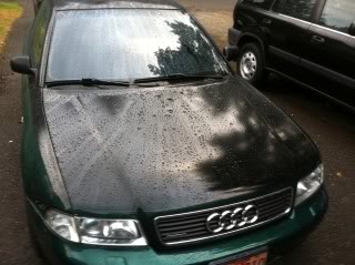

Well upon buying my car i was told that it was burning small traces of oil from the head. So going into i knew i had to do work to it, i drove it back from Oregon, and i licensed it with LEM plates. And put a nice wax on the satin black hood and on the rest of the car.
Size:  20.8 KB The water was beading off of it nicely.

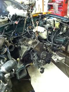

I went ahead and pulled the block.
Heres a nice pic.
Im gonna take it into a machine shop in seattle called NW Connecting Rod.
Ive heard great things about them and they said they'd do a bore for me for 150$.
Now i just need to figure what bore i want, so i can order some new JE pistons.
