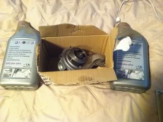

The new water pump

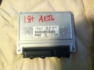

A separate ecu i bought to send to Eurodyne for my 830cc file.

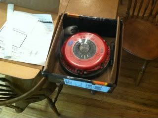

My Stage 4 extreeme south bend clutch with flywheel

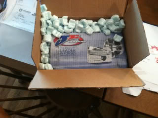

The pistons arrived!

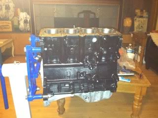

Update.
I got the block back,
Nw-Connecting Rod did a GREAT job on it.
There a few good old boys, and don't come across as the friendliest but i will use them in the future.
My brother in law tried to pick up my block while i was gone and dropped it and bent the trigger wheel, so NW CON ROD fixed it for free.
I was very impressed.
I ended up getting the crank polished, the rods rebuilt, steel bearings, the rotating assembly balanced along with the new clutch setup.
Hot tanked, Bored, and they added the paint which i thought was a nice touch, resurfaced everything, and resurfaced my old flywheel.
i went ahead and bought a engine stand so i could assemble the engine

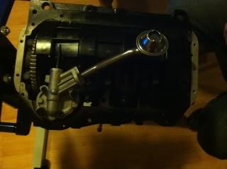

I bought the Oil sludge repair kit off of Ecs tuning, which came with a new pump and pick up tube which i installed.

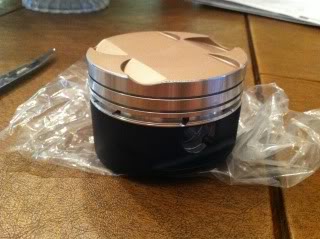

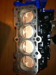

And heres a shot with the coated pistons, Looks pretty sweet.
Ill keep everyone updated, the breather off the crankcase i learned was allowing the engine to breathe but ended up getting clogged from all the oil that wasn't being caught.
So a oil catch can is also in my future.

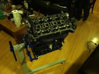

I bolted up the head last night.

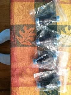

830cc injectors

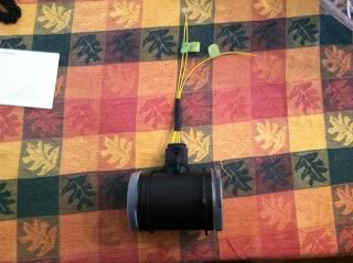

V8 MAF

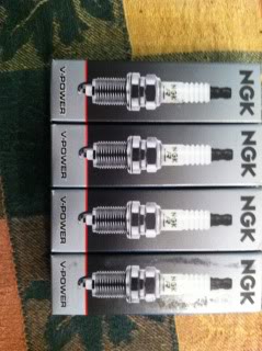

Ngk BK7RE Plugs

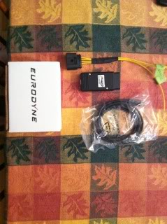

And my EuroDyne Maestro 7 setup
