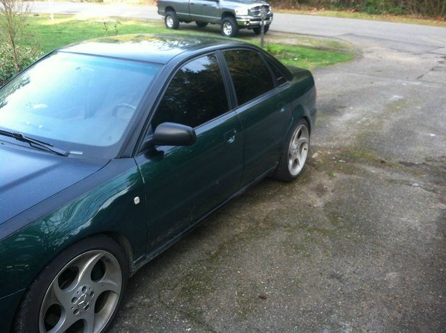

pics are decent. I'm really not feeling the twists. it isn't that they look bad, just not to my tastes. also not liking the way your photog chose to shoot in relation to the sun. the backlighting in most of the pics doesn't do your car justice in my opinion. the shots where your car is well lit, I like the way that green pops.

Well thank you for your honesty!
These aren't done by a photographer, this is just right down the street and i just took with a digital camera, just for some clarification.
But i agree, i took way to many with the wheels turned.

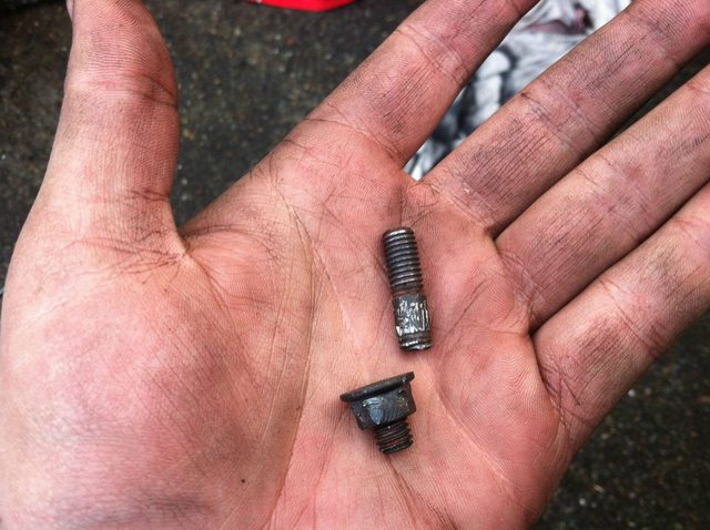

So yesterday i was getting a weird whistling noise in low rpms, so i figured it was an exhaust leak.
This morning i went out to check it out and in between my exhaust manifold and turbo there was a slightly bigger gap than normal, so i hit the throttle body and exhaust gases came out and hit me in the face.
So i took a wrench to start tightening down the nuts and under probably 7 ft lbs of torque the stud snapped.
So i had to pull the turbo, and extract the old manifold studs including the snapped one.
Luckily a local auto parts store carried the studs.
Needless to say i bolted it all back together and it was about a 3 hour job, but i'm glad i fixed that.
Plus the old studs were fubared.

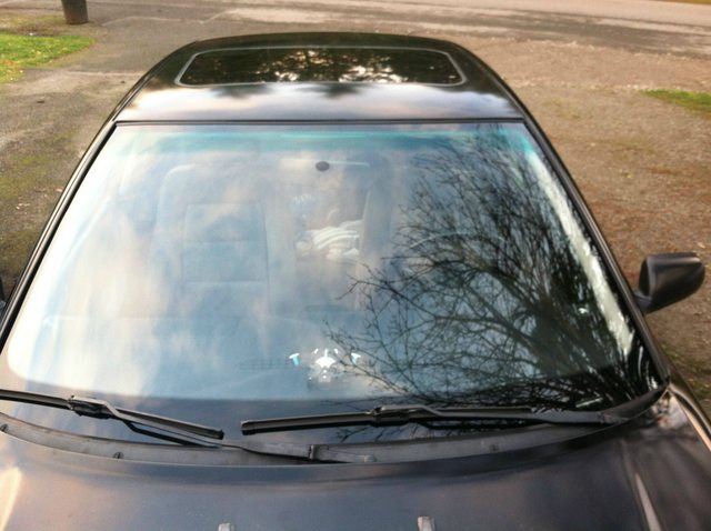

Ok! i got my windows tinted!
here's a real quick pic i snapped.
