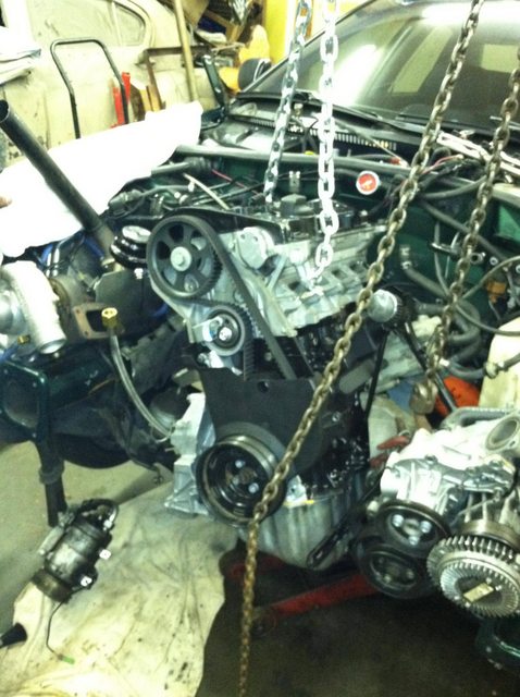

Dropping in the engine

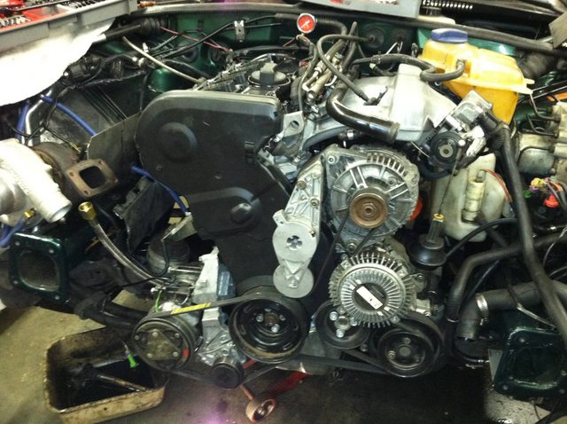

Accessory belts along with the 120 amp alternator

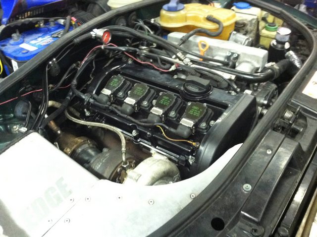

Everything assembled and mounted, painted the valve cover satin black to match the block and car.

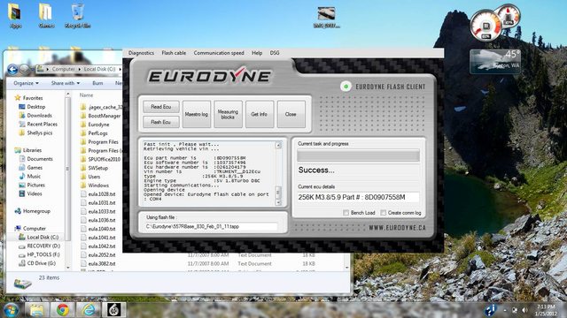

So today i received my cable, and i attempted to flash my ecu from my old a4 and this is what i got.

My battery was dead so i had to jump it, and it took awhile for the new tune to get adjust to my car but it's amazing how quickly the a/f ratio dialed right in and start running perfectly.
Running 13 psi with this tune compared to the old tune there is significantly more power and the exhaust note is a lot louder.
