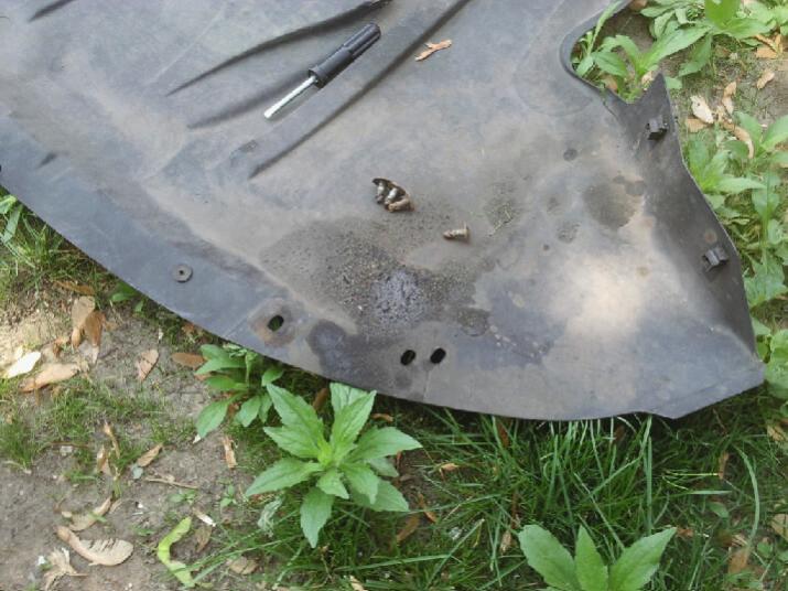

Hello guys im trying to find out why my car is making whale noises still... I jacked up the car and noticed one leak on the scrape plastic.... and the origin of the leak as well.. the fluid is very thick... like honey... where might it be coming from..

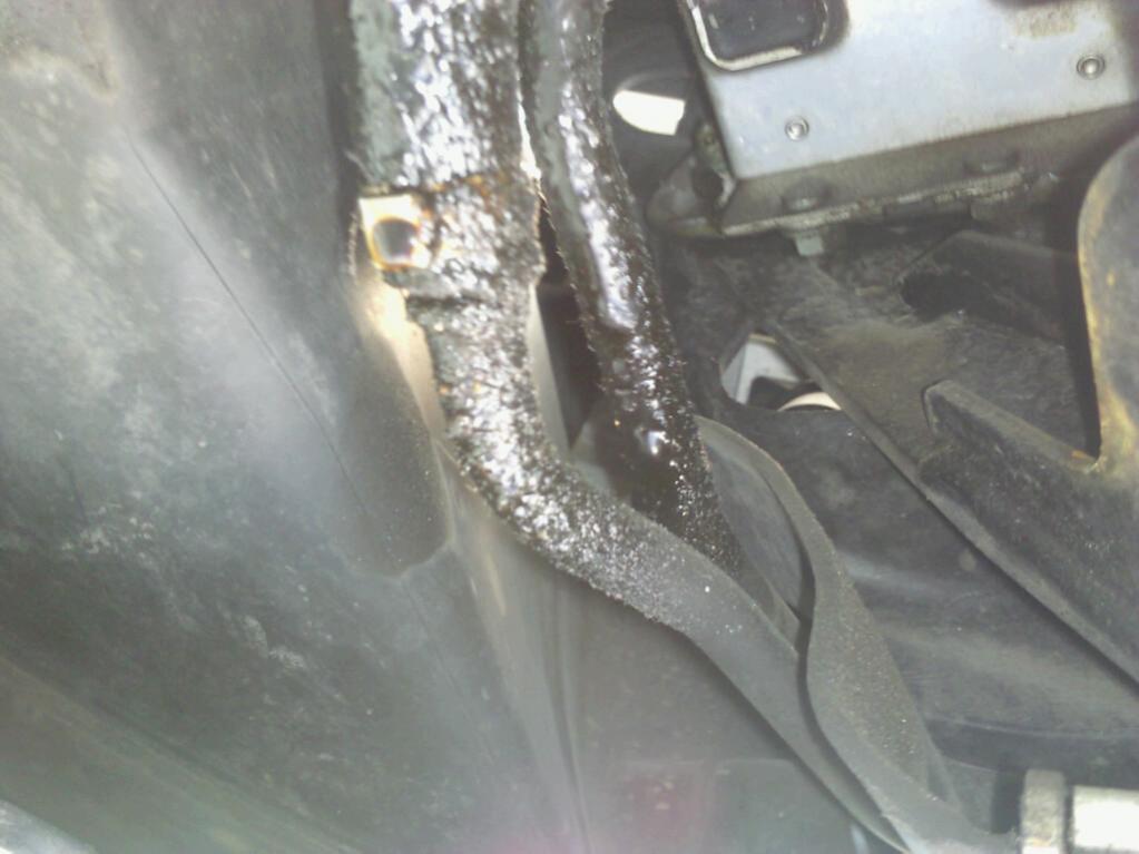

okay there are two tubings coming from the PS reserve... One leading to the power steering pump and the other one going some where else.. the Tube # 2 is the one that is covered with the "sap" like gunk... Im also trying to take off the stock clamps how would i be able to do that..???

one hose goes to the power steering rack, the other one comes back from the PS rack. i have a slow leak from the same hose, the clamps are crappy. its a common problem. just cut the clamps off and replace them with better ones.
