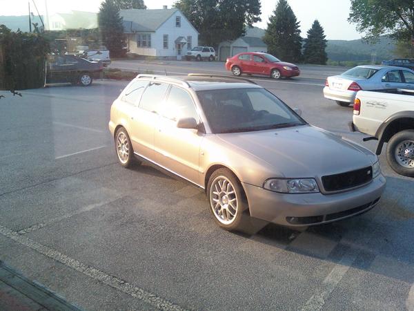

shamokin...you? Heres a pic.
Attached Thumbnails Just bought a 99 have a few questions-downsized_0820001847.jpg
