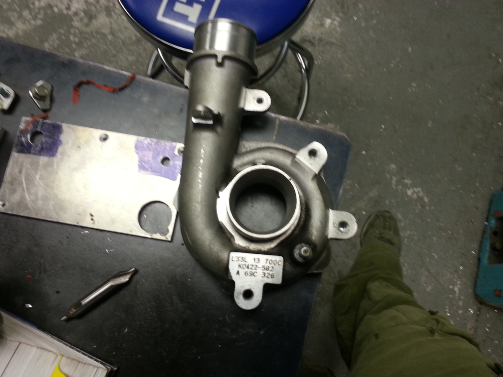

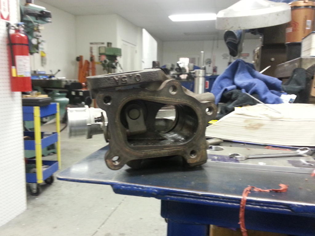

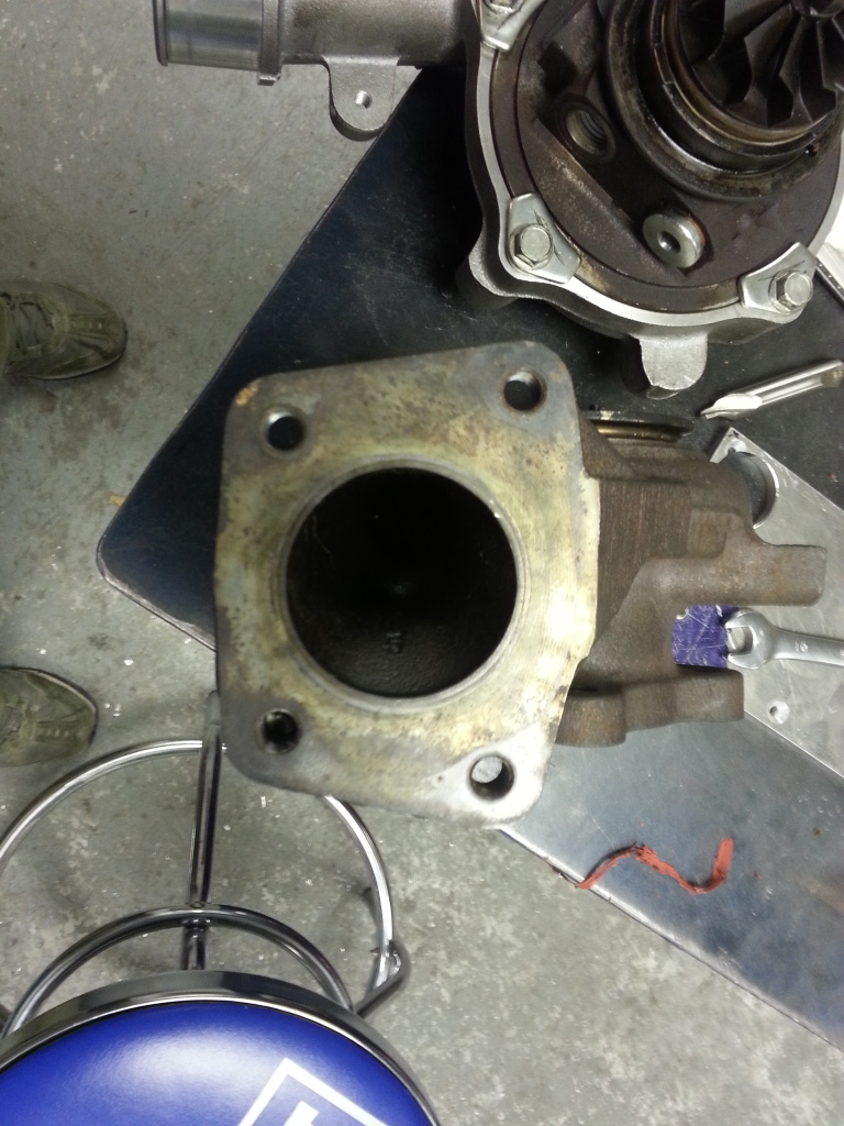

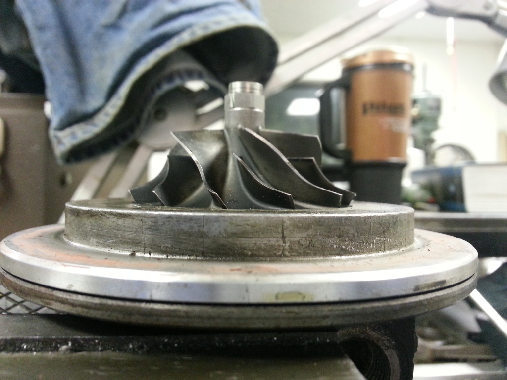

Here is some pictures of the CX7 turbo. The MS3 has a larger compressor but is physically identical. The CX7 should also make 250awhp as well. I am going to use a V band downpipe to attach it to the exhaust.
The flow map is on the frankenturbo site. It is literally the EXACT same compressor however the benefit other then cost of this unit over the frankenturbo is the exhaust housing and its AR. The biggest problem with the K04 is that the turbine housing is specifically designed for spool but at higher flow rates the nozzle in the housing becomes a limiting factor as it is not designed to sustain higher flow rates. What happens when the turbine housing can not handle the additional flow beyond its design is that it literally backs exhaust flow back into the combustion chamber and causes pumping loss which robs hp directly from the crank. I feel that I honestly need a better turbo manifold as well to get everything from it but too give you an idea the CX7 turbo makes 240chp in stock form with gobs of torque but it used in 2.3 liter. The MS3 turbo uses an even larger compressor and better exhaust housing. They are both the same size physically and I also have the MS3 turbo as well which I ultimately plan on using.
