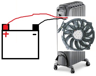

Only thing left to check at this point is the breathers....come one guys what am I missing here!?...and That fan Idea was clever I give you that...however i know for a fact it wouldnt have pushed the warm air efficiently lol...

on a side note, here was the fan idea. while we were putting his car back together( core support, radiator, condensor) it was mad cold outside and we were in a garage, but it was cold like 12*F. well there was this space heater and we had a spare radiator fan and jumper cables. such as the scale image shown below. and this was gonna heat our garage like a turbo fan... never got the chance to try it so oh well. probably wouldnt of done much anyway lol...

No one cares about your failed heater fan lol...Thats why they invented torpedo heaters for optimal heating ability!! lol...
