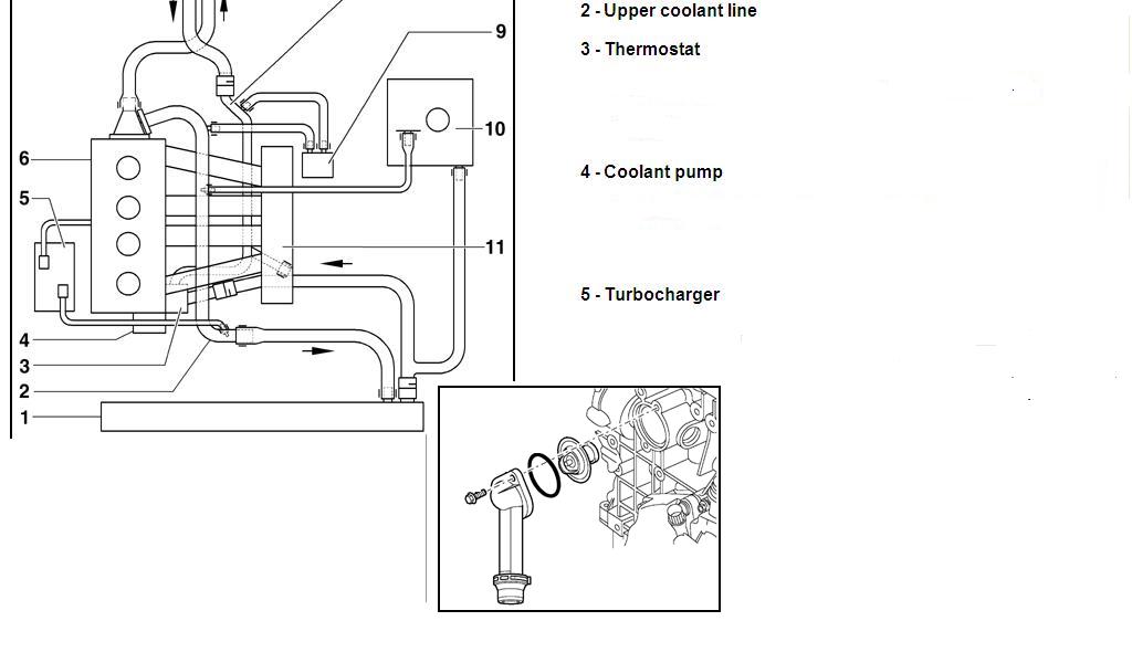

I just did a thermostat on a 2001 awm engine, its behind the alternator on the block, you can change it without removing all that other stuff. its also a pita.
