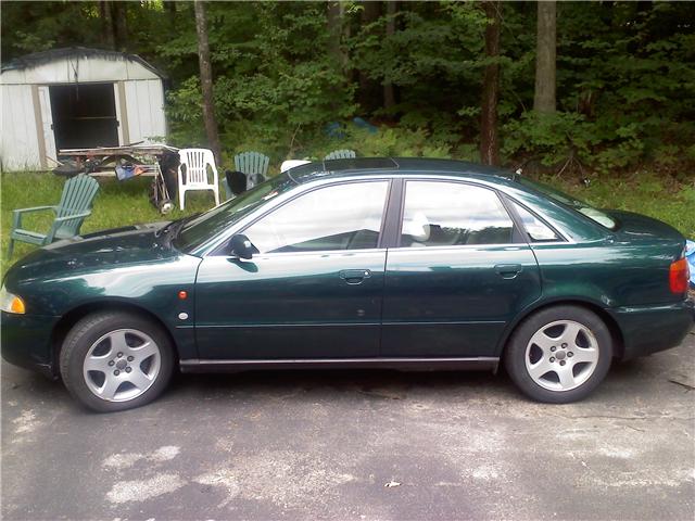

Old Jul 30, 2009 | 06:38 PM
paintballcs's Avatar
Joined: Jul 2009
Posts: 84
From: New Hampshire
added a picture of it currently.
