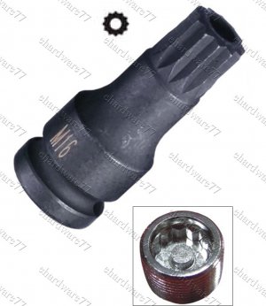

jonbonesjones's Avatar
Moderator
Joined: Aug 2011
Posts: 2,380
minus the fact theres a pin in the middle and there needs to be a hole in the middle of the toolName:  4b47b9c2a1021_17095n.jpg
