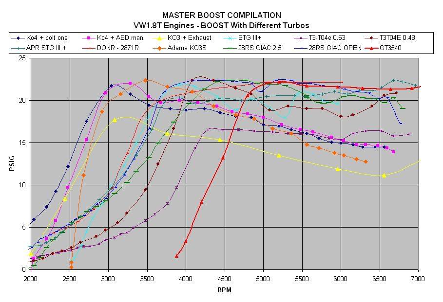

You can try using parts store MAF cleaner, but its very likely your MAF is toast. Common problem with K&N cone filters because they're usually over-oiled. My suggestion would be to switch to an AEM dry element filter.
As for the K04, you should be ok with just the turbo. What do you mean by "higher" RPM's? K03/K04 turbos pretty much run out of breath above 4500rpm, this is evident by looking at a dyno sheet. This is directly from the FAQ sticky at the top of this forum:
The K03 is the yellow plot.
