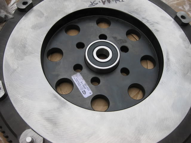

Picture of the bearing he used as a pilot bearing. I have another customer that lives here in socal that did the tip to manual swap on her B5.5 Passat 1.8t. She too used the same bearing and also went with a CM clutch/flywheel kit.
Info for the bearing
-$19 Pilot Bearing from www.zorkos.com PN#A-6941
If I had the specs for the bearing I could most likely get it right from Clutch Masters.

SO I grind the crank. Install flywheel and place this bearing in flywheel and then bolt tranny up?
But I thought you said your flywheel fits on the crank already?
If so then you just need to get that same bearing in the conversion link and place it in the center opening of the flywheel to act as a pilot bearing.
It does fit. So that's it ill be fine? Id hate to put it back together and it not work.
