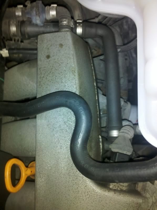

I've been getting terrible gas milage lately (about 15 mpg) so I looked under the hood and saw a couple things that made me cringe. First is this:
I have some sort of leak that hopefully you can see is on the upper part of my intake manifold, I thought it was it was from the coolant reservoir at first because that tube is right above it, but that tube is perfectly fine. And going to smell it it almost smelled like oil so if anyone has any idea thatd be great.

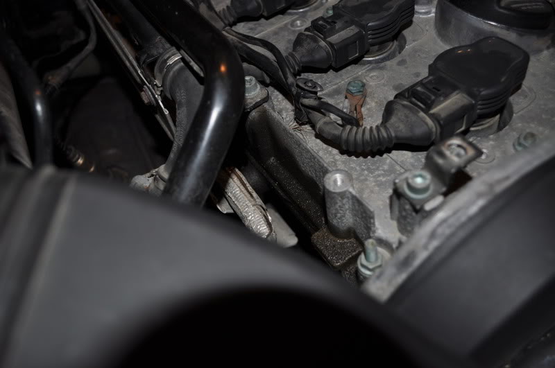

Decided to take off the engine cover to and found this...
Can someone pleaseeee raise my hopes and tell me thats something besides the head gasket?

If you mean the wetness on the valve cover sides, that's a valve cover gasket leak. Very common and about $25 in parts to fix. Tackle it at home or come on out and we'll knock it down.
