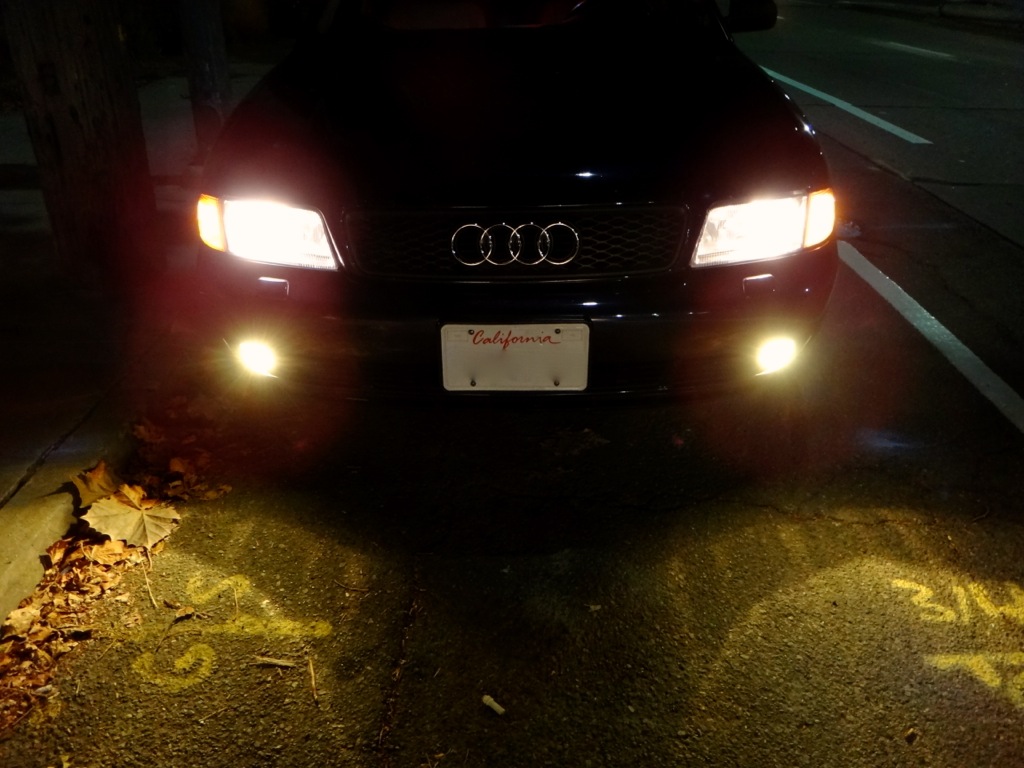

Applied yellow lamin-x to the fogs today. So far I like how it looks.

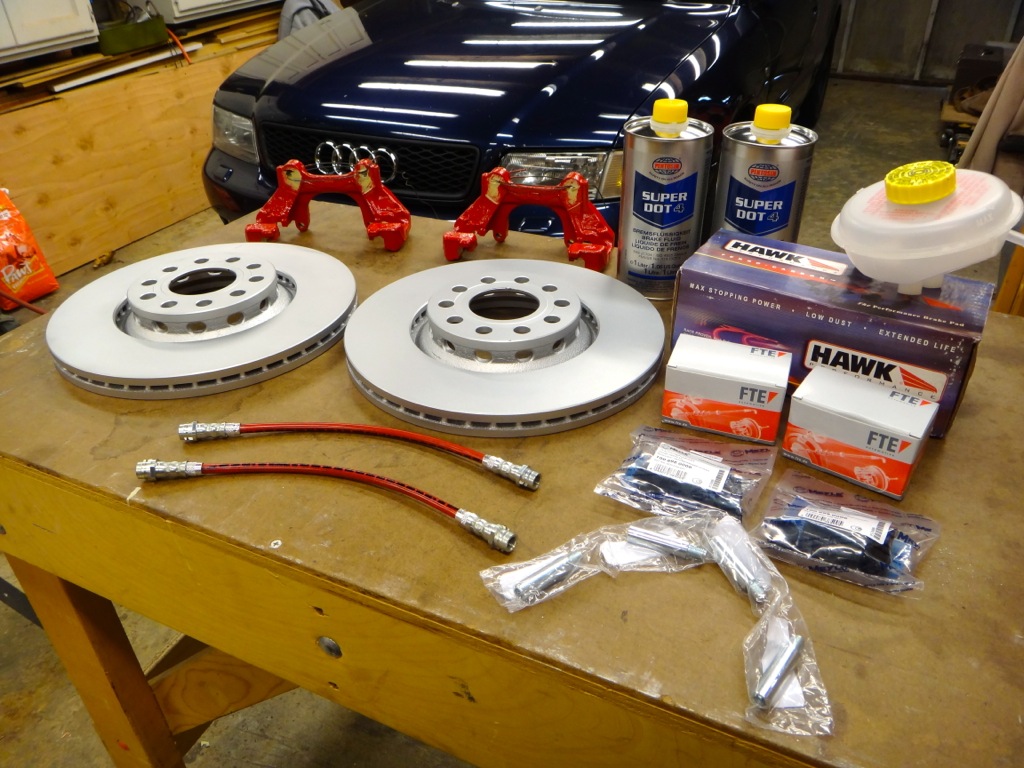

My pile-o-parts ready to be installed, almost. I was shipped a Meyle brake fluid reservoir when I ordered an OEM one, the new tank won't be here for a couple days. Then I'll get to installing. Not happy about the delay.

Installed Optilux yellow H7 bulbs in the fog lights yesterday. They're definitely yellow. Dunno if I'll keep them yet.

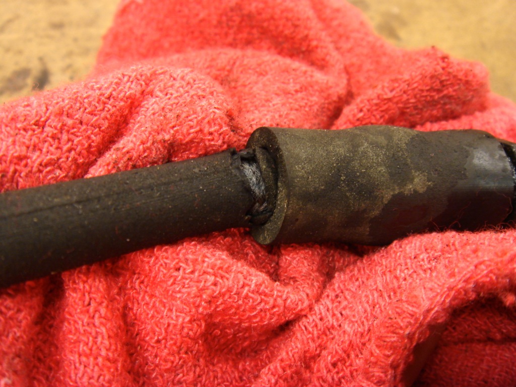

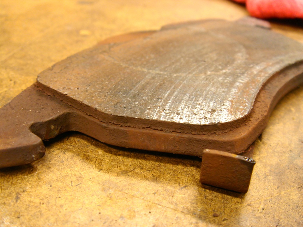

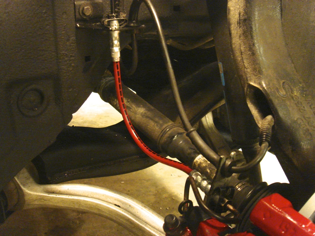

Progress.
Everything is installed, appears to be leak free, and is ready to bleed tomorrow. Took a lot longer than expected, one of these days I'll figure out that everything takes longer than expected.
Replacing the brake lines was one of the easiest parts. I ended up ordering an SK 9/11mm flare nut wrench, glad I did.
I plugged the brake lines with M10x1 bolts which helped slow the fluid leak down, but it was still dripping a decent amount. Probably lost a half liter from that.
I was inches away from blinding myself with brake fluid when I removed the first piston. Quite a stupid mistake, I was lucky. Always wear the proper protection! I promptly located my glasses..

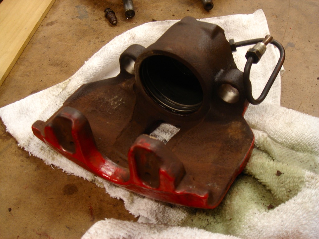

It also appears that the passenger rotor and caliper have been making contact. Not sure what to think of that.
Stripped caliper.
Looks nasty.

Carriers with new guide pins installed.

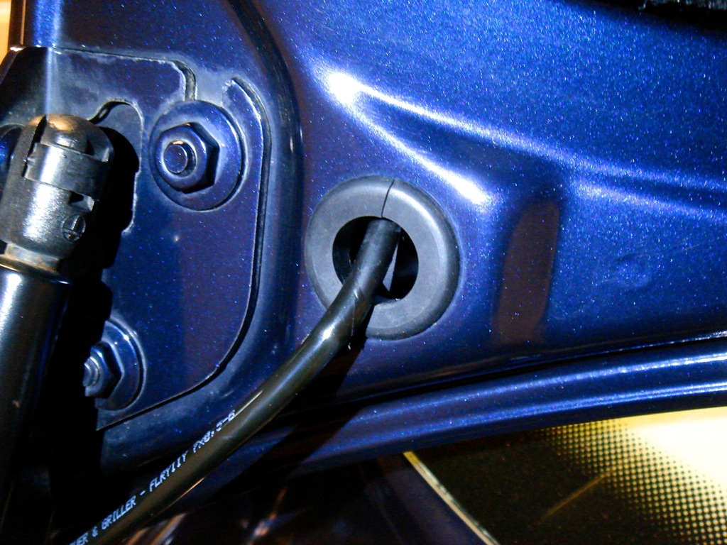

I took a little break to install a new grommet for the trunk wiring harness. Been meaning to do this for months.

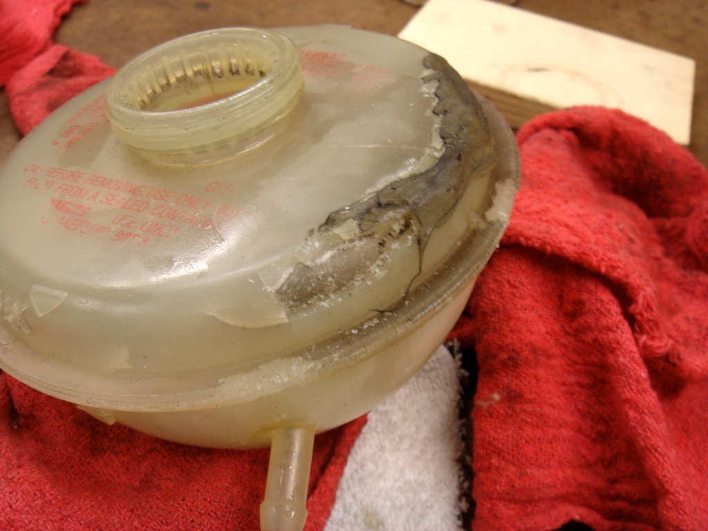

Here are the remnants of the old braking system. Doesn't look too good does it? The big chunk missing from the reservoir I dislodged while removing it, wasn't driving it cracked that horribly.

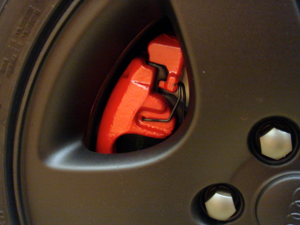

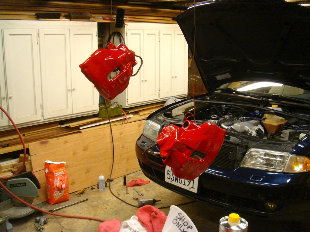

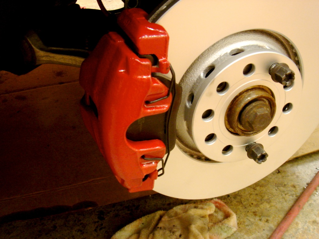

I pulled the caliper and replaced the white lithium grease I used on the guide pins with the proper disk brake grease. I also gave the springs a coat of flat black paint.

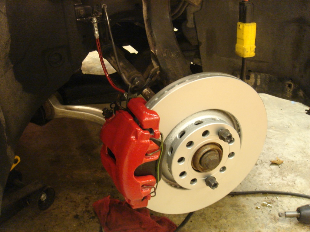

The finished product!

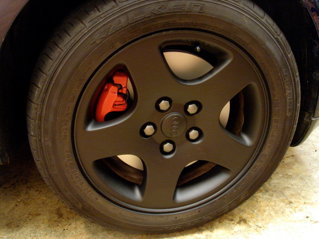

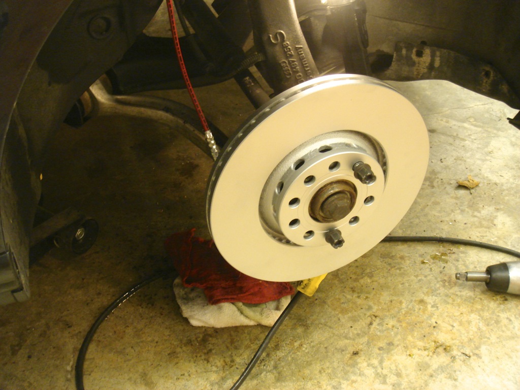

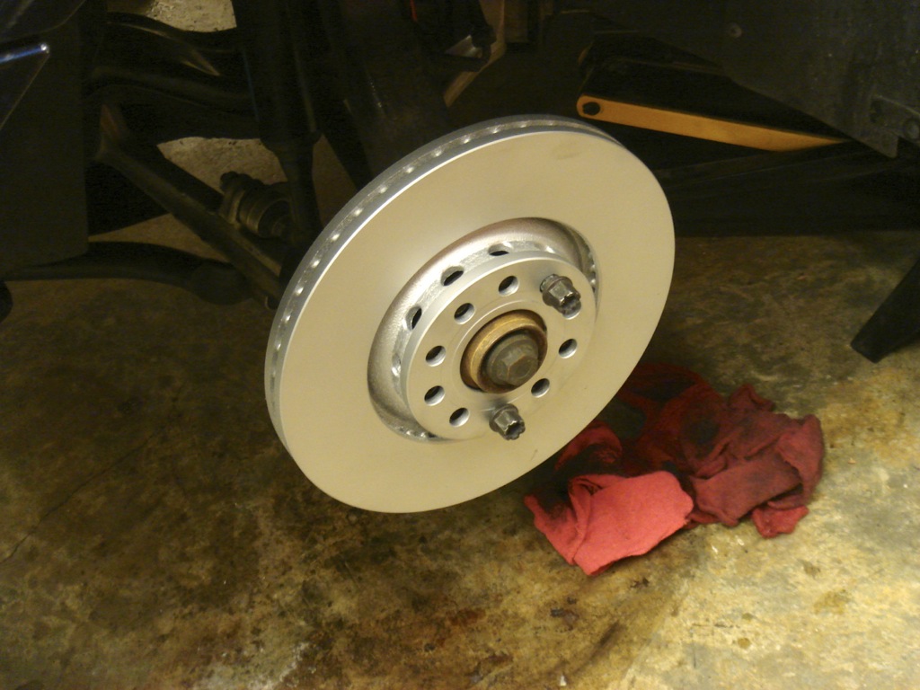

The A8 rotors really fill out the 16" wheel.
Before:
After:
