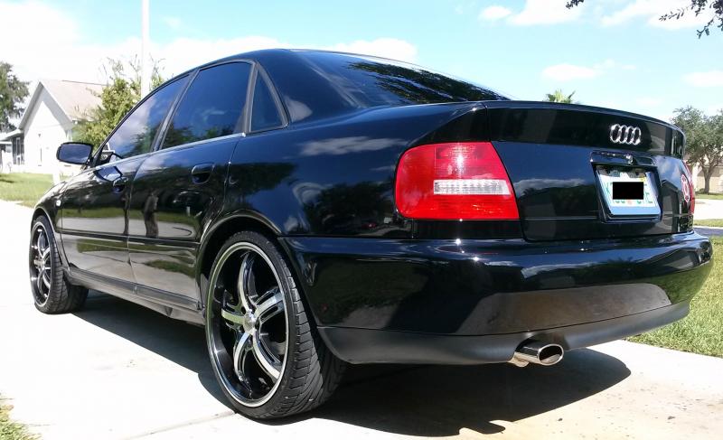

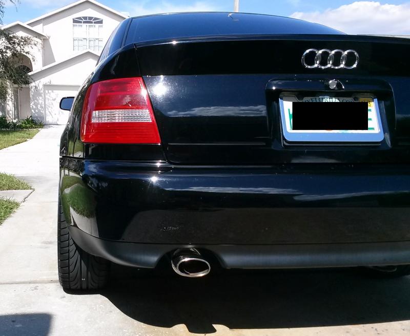

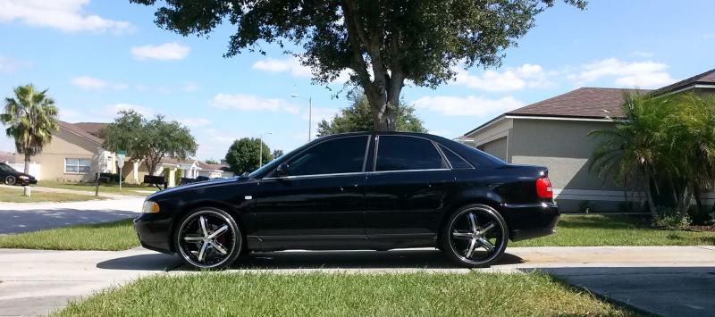

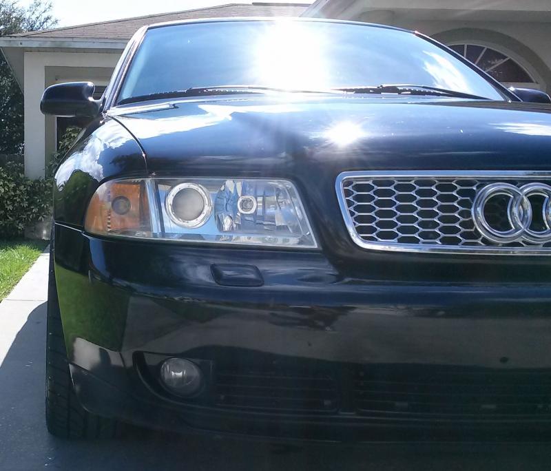

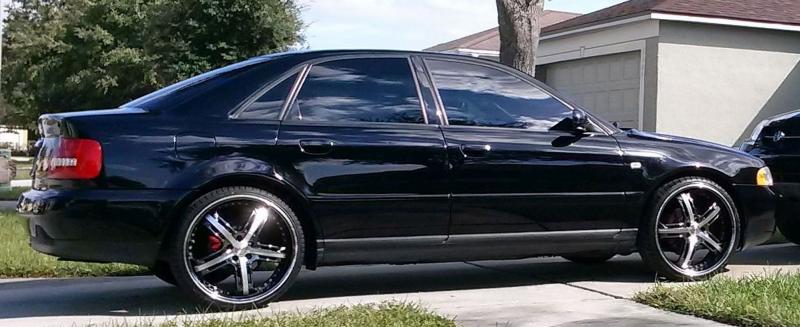

I have 20"s with the sport package (1" lowered stock) and I have no problems.
Here are some pics and wheel specs for you:
Audi B5 A4 - Sport package (stock lowered)
Rotor Diameter: 288mm (11 & ¾”)
Lug Pattern: 5x112
Wheel Size: 16”x 7” (stock)
Tire size: 205/55/16
Overall Rolling Diameter: 631.9mm = 247⁄8in
Offset: ET45 (mm)
Center Bore: B5-B7 all use 57.1, the B8's changed to 66.6
The standard wheel bolt is M14 x 1.5 x 27.5 and is to be torqued to 120Nm. The bolts are designed with a tapered shoulder.
